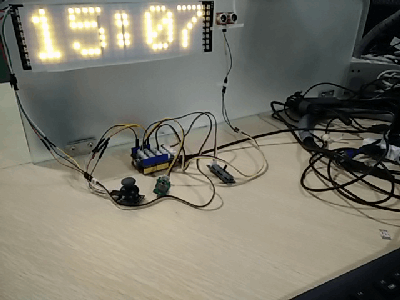

The whole circuit diagram is shown in the picture,

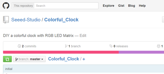

All the software has been uploaded to the gitHub, you can download it from here, put the library to the library path of your Arduino IDE(e.g. D:\Arduino\libraries) and then open the ColorfulClock.ino file, connect the arduino to your computer and compile( maybe you need to modify the code due to the connection of modules) & upload.

Now you can have a test with your colorful clock, put your LED Matrix to a right place for you, the corner of your table for example, and fix the ultrasonic ranger, you can even to DIY a box for your arduino if you like.
