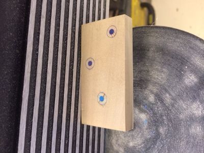

Step 3: Sqaure and Drill
The next step is to ensure all the blocks are the same size. If you used a table saw this step can be skipped. If you used a band saw or a jig saw this step is necessary for uniformity. I placed several blocks together on a table sander and smoothed the cuts and ensures they were all square. I use the mini square again to ensure they are all even and square.
After this is completed we can move on to marking centers for drilling. I first start by finding the center. Use and straight edge to draw a line from wood corner to center corner. Where the lines intersect is drill spot for "1". Ensure your drill press is square or hand drill is at a 90 degree. Drill each block separately and mark each block center before hand like I did before. Do not drill all the way through the block. Only drill to a depth of 1/4 inch.
Step 4: Place Your Pencils
Now that we are done drilling our first set of holes, we can start placing in the pencils. Place a small drop of super glue in the hole and drive in the back of the pencil. Should be snug enough for cutting. Repeat for the next domino.
Mark the other side of the domino and get ready to drill them. For the 1-2 block in the picture I found the center of the block and then found the center again and that marked the drill location for the 2's.
Repeat this same process until all blocks are drilled and pencils are placed.
