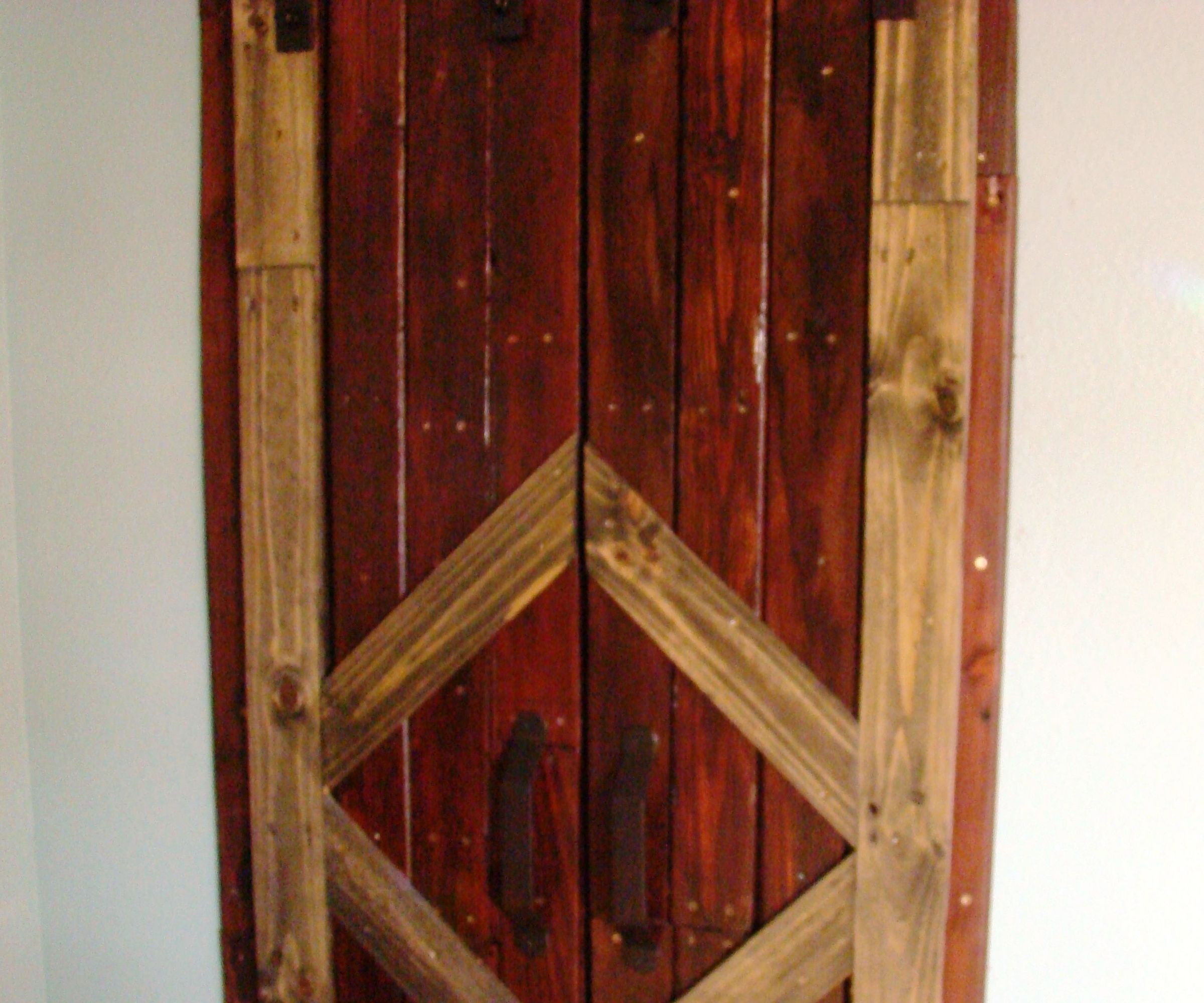

Let me first say that I have problems making anything square, so when you add in that I am using scrap wood to make this cabinet, it doesn't help with the square thing. Also, I like to use hardware cloth (I call it rabbit wire) for the face of the cabinets.
I put pallet slats across the front of the frame by the tile at the top, and on the front to frame out the place for the doors. That way you can use cheap strap hinges because they lay flat. I used my miter saw to cut pallet wood at 45 degree angles to make the doors, and I put little brace metal pieces on the back of the doors as well as putting screws in at the corners. Putting those brackets kind of kept it all together so I could put the doors together kind of square.before adding the screws on the side edges to hold it tight. Then I had to put it in the place where it goes on the front of the cabinet to play with it to make it fit. Notice how I had to put wood putty in the corners to make it go together properly? I didn’t allow for the thickness of the sawblade. And the brackets…..they make it all better for me. I think if I were to use plywood for the face instead of the wire, it would be easier to make it square, but I like how it looks with the wire, and the lights show through the wire nicely.
So then I put the hinges on the doors first instead of the cabinet, and then put them into the hole made by the pallet boards screwed onto the front of the cabinet, and screwed them into the cabinet with a shim underneath the doors so they will swing freely when the hinges are screwed in.
