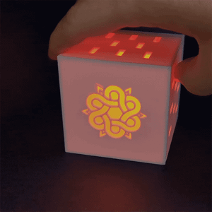

A LED cube with an automatic color change is to be built. To realize this, the LED ring, the gyroscope, and a D1 Mini ESP32 are used. With this project, the color of the LED ring can be controlled by gyroscope and ESP32 depending on position. In the video, this is clearly shown using a 3D printed cube that lights up in a different color with each rotation.

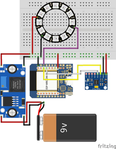

Step 2: Wiring
