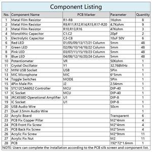

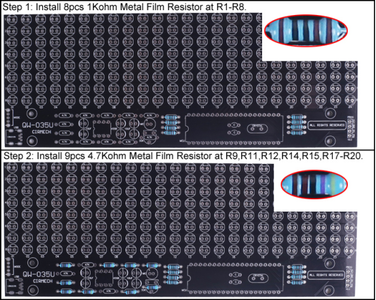

Step 1: Install Metal Film Resistor

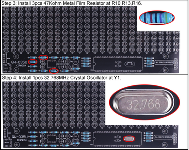

Step 2: Install 47Kohm Metal Film Resistor and 32.768MHz Crystal Oscillator

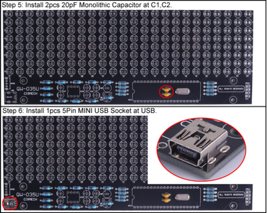

Step 3: Install 2pcs 20pF Monolithic Capacitor and 1pcs MINI USB Socket

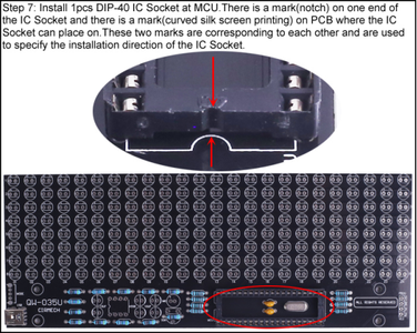

Step 4: Install 1pcs DIP-40 IC Socket

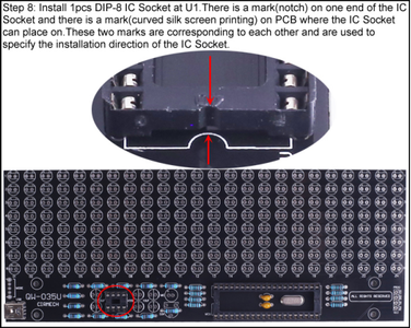

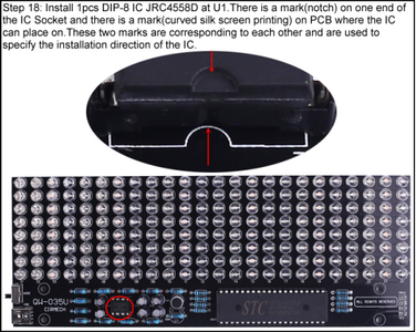

Step 5: Install 1pcs DIP-8 IC Socket at U1

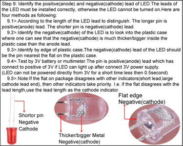

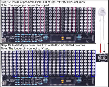

Step 6: Let's Learn How to Identify the Positive(anode) and Negative(cathode) Lead of LEDs

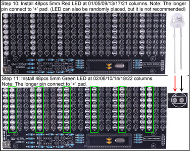

Step 7: Install 48pcs Red LED & 48pcs Green LED
Step 8: Install 48pcs Pink LED & 48pcs Blue LED

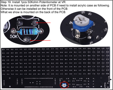

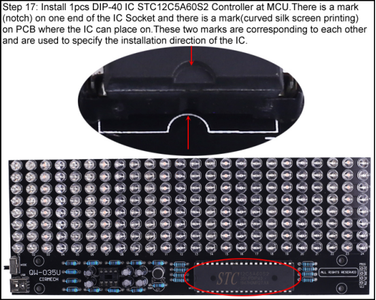

Step 9: Install Toggle Switches, STC12C5A60S2 Controller, DIP-8 IC JRC4558D, Potentiometer
Install the followings:
  • 1pcs 5Pin Toggle Switches
  • 1pcs DIP-40 IC STC12C5A60S2 Controller
  • 1pcs DIP-8 IC JRC4558D
  • Install 1pcs 50Kohm Potentiometer at VR

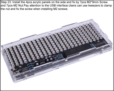

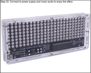

Step 10: Install Acrylic Shell

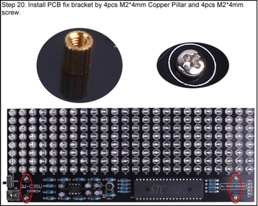

  • Install PCB fix bracket by 4pcs M2*4mm Copper Pillar and 4pcs M2*4mm screw.

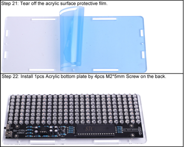

  • Tear off the acrylic surface protective film.
  • Install 1pcs Acrylic bottom plate by 4pcs M2*5mm Screw on the back of the PCB.
  • Install the 4pcs acrylic panels on the side and fix by 7pcs M2*9mm Screw and 7pcs M2 Nut.Pay attention to the USB interface.Users can use tweezers to clamp the nut and fix the screw when installing M2 screws.

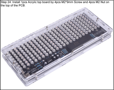

  • Install 1pcs Acrylic top board by 4pcs M2*9mm Screw and 4pcs M2 Nut on the top of the PCB.
  • Connect to power supply and music audio to enjoy the effect.
Step 11: Done!
This colorful led music spectrum display kit really is a very interesting DIY electronic product which enables users to understand the circuit more clearly and learn soldering skills.
The light effect is cool. We have tried the finished product on the desktop in office, it makes a silent working day with a bit more energy.
