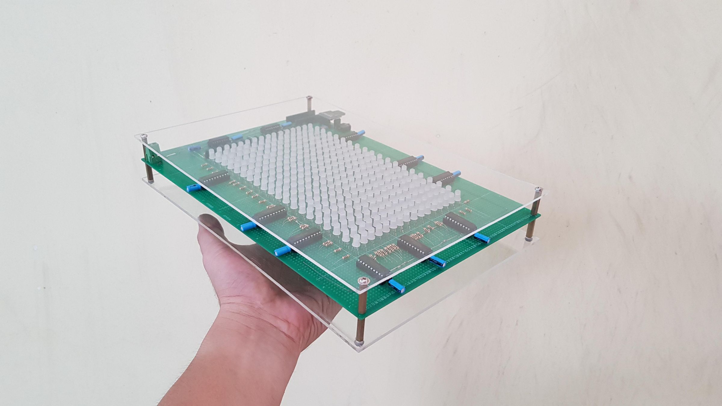

I have built one RGB led table 16x20 which was controlled by SPI protocol, and reserved 4 control pins for future applications as follow:
  • DATA PIN
  • CLOCK PIN
  • LATCH PIN
  • BLANK PIN
You can check how I built this led matrix at: https://www.instructables.com/ATtiny85-Spectrum-A...
My idea is to combine this led board and Grove Beginner Kit to display information and make color customizations based on Grove Beginner Kit built-in sensors.
Step 4: Schematic
You can download the project schematic in PDF format HERE.
The components for controlling a RGB led matrix 16x20 via SPI:
  • Columns (cathodes) scanning: including 3 groups of TPIC6B595N to control 20 columns, each group includes 3 x TPIC6B595N for 3 colors: Red, Green & Blue.
  • Rows (anodes) scanning: including 2 x 74HC595N and 16 x A1013 transistor to control 16 rows.
The connection between Led Matrix 16x20 and ATmega320p based Seeeduino Lotus on the Grove Beginner Kit is as follow:
  • DATA_PIN: connect to Seeeduino Lotus pin D11 (MOSI).
  • CLOCK_PIN: connect to Seeeduino Lotus pin D13 (SCK).
  • LATCH_PIN: connect to Seeeduino Lotus pin D2.
  • BLANK_PIN: connect to Seeeduino Lotus pin D7.

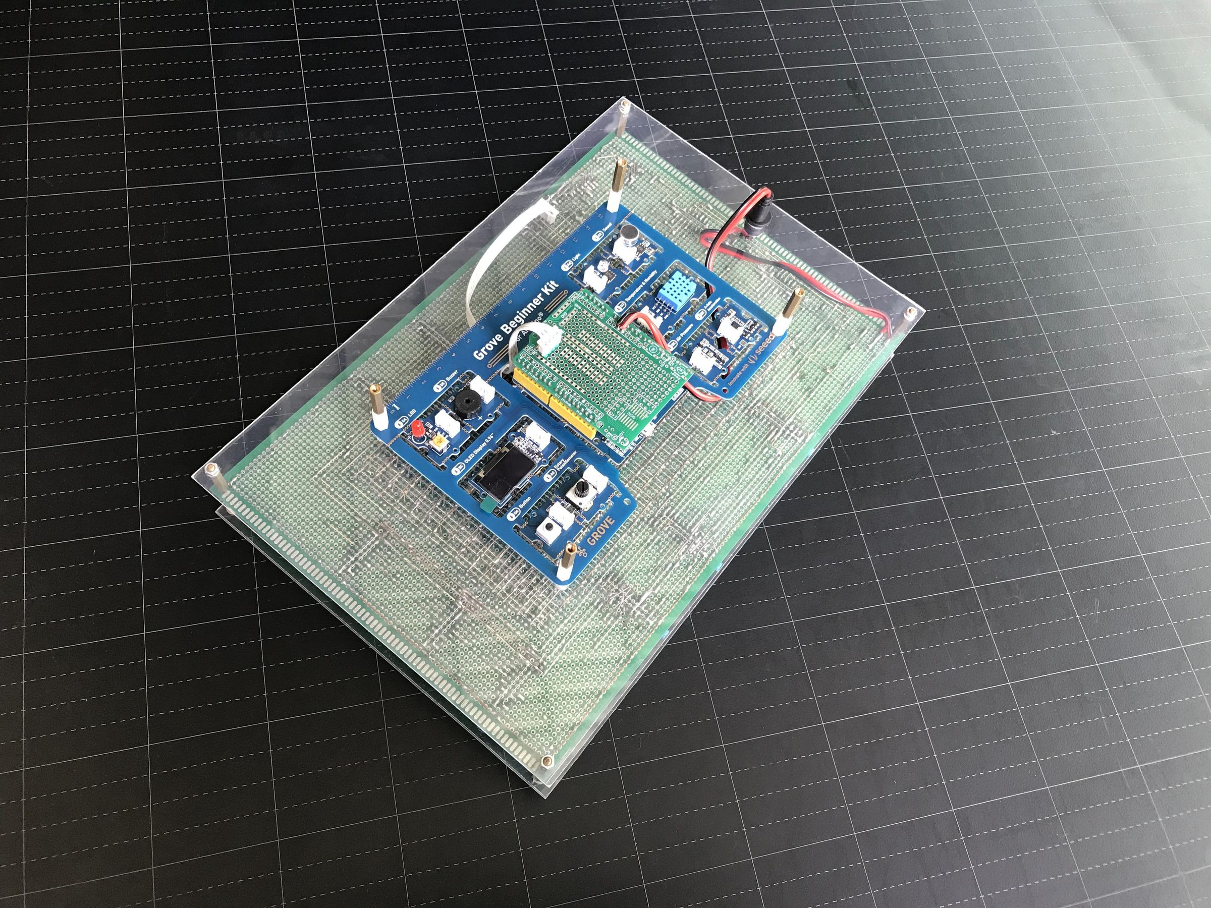

Step 5: Soldering and Assembling Works
  • Soldering a RGB Led Matrix 16x20: I reused this led matrix from previous project. You can check detail at:
https://www.instructables.com/ATtiny85-Spectrum-An...
  • Soldering 4 SPI pins male header on a Proto Shield for Arduino.
  • Proto Shield for Arduino was plugged on the Seeeduino Lotus and Grove Beginner Kit was mounted on the backside of led matrix. Then I connected 5VDC power supply and SPI connection to Grove Beginner Kit.
  • Ready for programming.

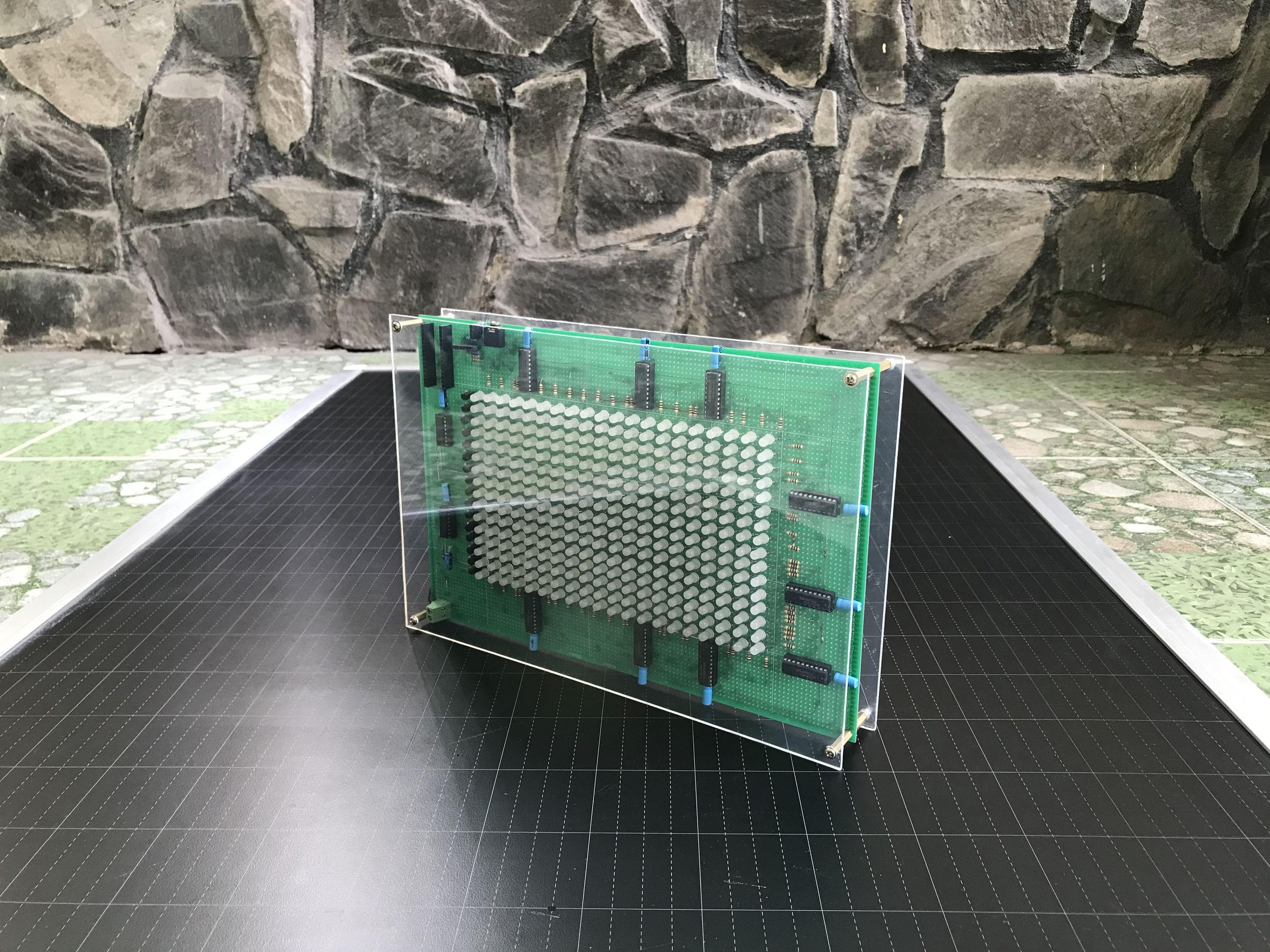

Step 8: Testings & Conclusion
Grove Beginner Kit worked great with RGB led matrix through SPI protocol. Many built-in sensors can be used depending on our creativeness, just with one Grove Beginner Kit.
