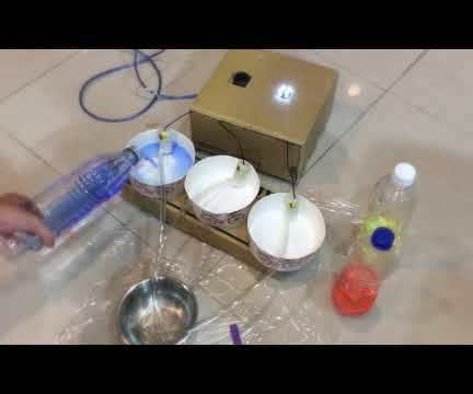

Step 4: Using Your Colorful World
Connect the USB cable to the Arduino and after the power is turned on, you can start using it!
Select an item with bright colors, place it 1cm away from the RGB color sensor, and press the button. The color of the item will be displayed on the LCD panel, and then the RGB LED will also illuminate the lamp similar to that color.
Due to the limitations of the LED lamp, it can not illuminate very precise colors. For example, it cannot illuminate black or gray color, because the material of the LED itself is white. Dim and less bright objects will decrease the effect, the surrounding lights and the reflection lights will also cause it to sense the false color, so it is recommended to use it in a dark room.
