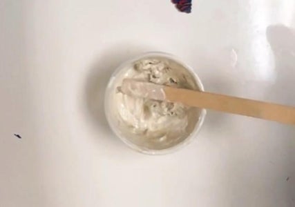

You will take a small piece of QuickCure Clay and put it into you small potion cup. Then add a little isopropyl alcohol, gently mix together. You will need to breakup the Clay as you mix. You are looking for the consistency of cookie dough or thinner if you are going to be piping the clay.
Now add a toothpick of universal tint and mix. Keep adding till you achieve your color choice.
Now let sit over night so that the alcohol will evaporate. This insures that the clay will stiffen some, making it easy to work with.
Your colored clay is ready to work with , add a little baby powder to your gloved hand and start forming.
