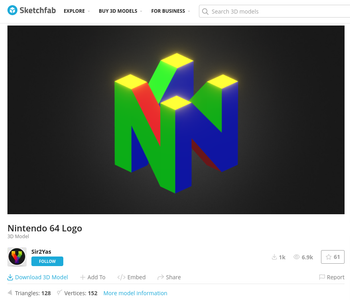

Step 1: Find the Model
Firstly, you'll actually need your model. There are two ways you could get this model. You can sketch the model yourself via Fusion 360 or you can download a free one off the internet. The one I used was made by Sir2Yas and licensed under Creative Commons Attribution.
