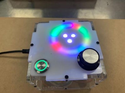

Introduction: Colorize: Color Wheel

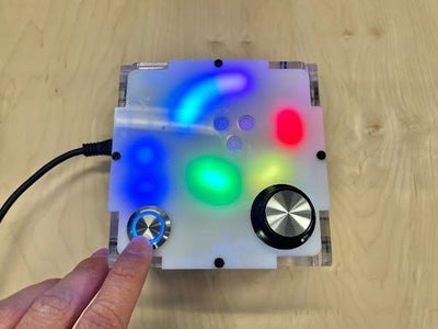

Explore the tertiary colors with the color wheel activity! Use the dial to select red, green, or blue on
the LED button. Press the button to submit that color. Repeat that process 4 times and watch the
colors combine and get placed on the color wheel.
NOTE: This activity is generally for the older kids in our intended demographic, 1st - 2nd Grade.

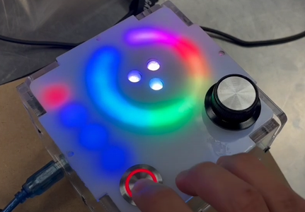

This activity has 2 modes! Touch the red touchpad on the back for a few seconds to switch modes.
Fill the color wheel (problem-solving mode): This mode has more of a problem-solving aspect to it.
Once 4 colors are selected they get submitted to a color wheel in their correct location. Figure out
all combinations to finish the color wheel. Sounds will play as the colors are combined with a
higher-pitched note playing for new color combinations entered and a lower pitch sound for
re-entering a combination that has already been filled on the wheel. Fill it all in to see a light show!
Make your own color wheel (creative mode): This mode lets add whatever colors you want to the
wheel! Use the same input to mix colors and put them on the color wheel. When it's all filled up a
light show will play.
