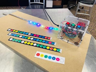

In this activity, the children can press the red, green, and blue buttons to light up a light on the LED strip. Filling up the light strip causes a short light show to happen. Musical notes will then play corresponding to each color. Multiple buttons can be pressed to combine the colors and get new notes. All three buttons pressed will make white light which is silent and can break up the music. There is provided music notation that will play a few common children's songs and provide the notes of each color. You can also turn on and off the sound using the small red touch panel on the back of the hardware.

Step 2: Attach All the Hardware
You will need to screw the Arduino in the bottom.
Screw in the capacitive button. (Please add the appropriate headers as well)
Make sure you wire the resistors to the buttons as well.
The resistor used is the 220-ohm resistor.
Please note that the toughest thing to wire is the button itself.
There are four nodes on the button. + and - are for the Led which needs a 220-ohm resistor. and the two terminals on top are your switch which becomes a closed circuit when the button is pressed.
the button connects to 5V, GND, and digital input.
Check the photos on how I did the wiring for the buttons personally

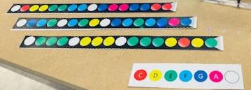

Step 5: (Optional) Cut Out Some Tunes
Print the pdf below on A4 paper. Cut the strips and you should get 3 strips.
Each of these strips plays a different tone.
