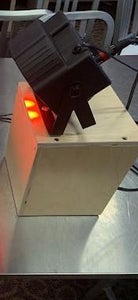

Step 2: Make a Stand for the DMX Light
We made a 10x 8 x8 inch box. This would be a stand for the DMX light that shines on the whiteboard
