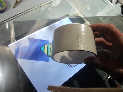

Step 1: Setup

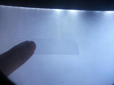

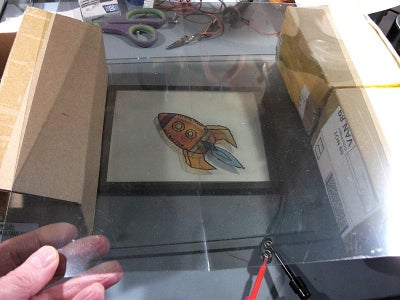

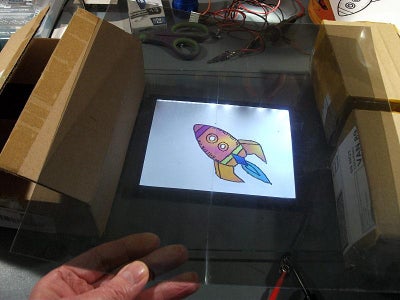

Place the polarising filter over the light table, or up against a window. Place the sheet of glass or acrylic over it. This will be your artwork. Then place the second filter over that. Leave a gap between these two; you'll need access to the space between the two filters. Or, if you are using sunglasses, put them on. Remember, the sunglasses need to be polarised otherwise it won't work. You can test this by tilting your head from side to side. If the filter goes lighter or darker, the glasses are polarised. If the filter doesn't change, they are just ordinary sunglasses.
Step 2: Select Your Colours

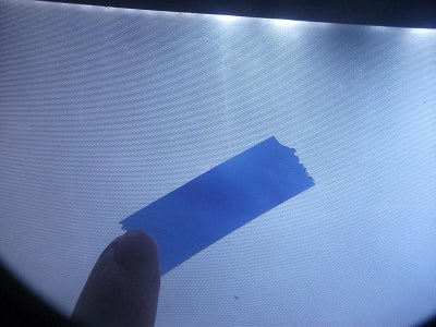

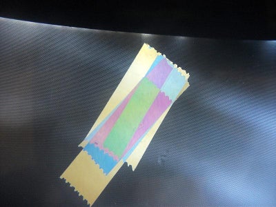

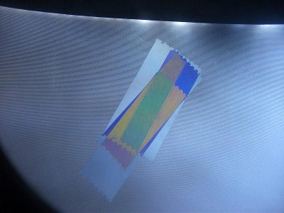

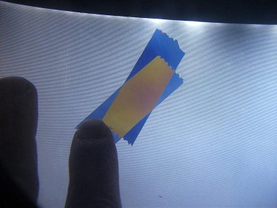

Now you have your setup, it's time to play around with the tape. Tear off a small length of tape and place it on the glass, sticky side up. You should have the sticky side up so that it doesn't stick to the glass, since you're going to be rotating the tape to check out the colours. In this demo, I just used ordinary sticky tape rather than packing tape, but it all works the same. All that is required is for the tape to be transparent
And that's it. Rotate the tape, and also the upper filter, and you will see different colours on the tape, and sometimes no colour at all.

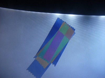

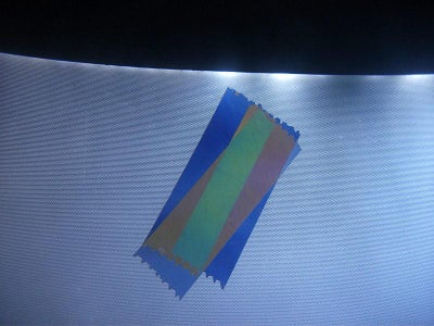

Once you've got a colour you like, turn the tape over and stick it to the glass. You need to place the tape at exactly the same angle as when it was the other way up, so that you get the same colour. When you stick it down, fold the end of the tape over on itself so that you have a tab at the end that hasn't stuck. this is so you can remove it again later. This step is just a test so that you can get an idea of how this whole thing works.
Now tear off another piece of tape, and repeat the above process, but this time over the piece of tape you already put down. Notice how new colours appear that you didn't get with the first piece. This is how it works; successive layers of tape produce different colours.
And of course, rotating the filter changes all the colours. Try it!

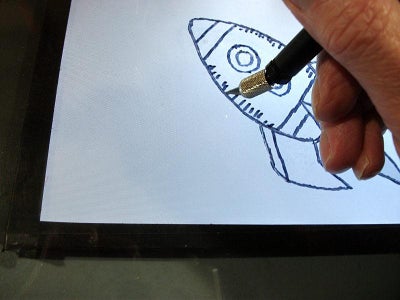

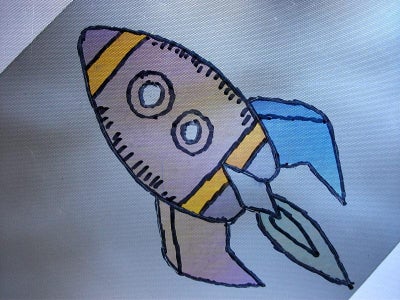

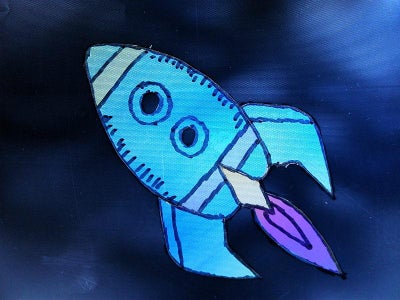

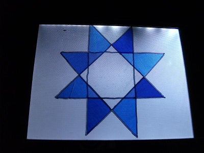

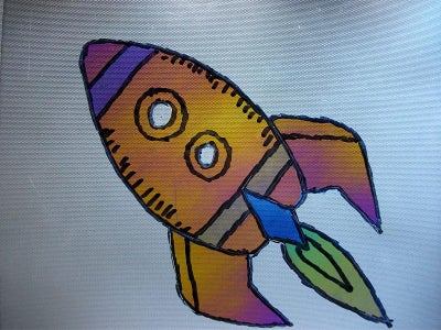

Step 3: Draw Your Picture

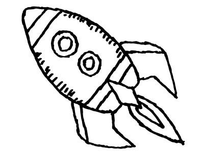

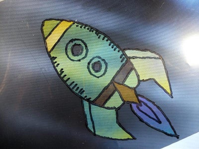

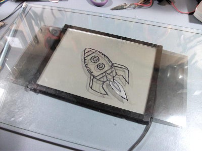

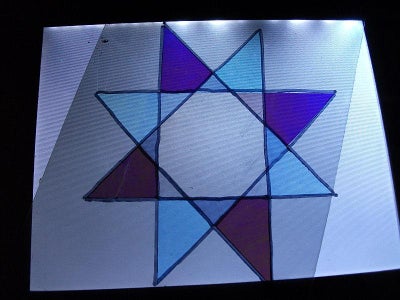

For my picture, I just picked some random clipart. Then I simply traced the design directly onto the glass with a Sharpie.

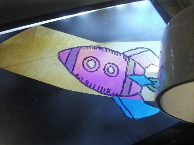

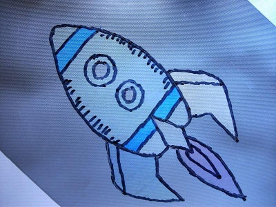

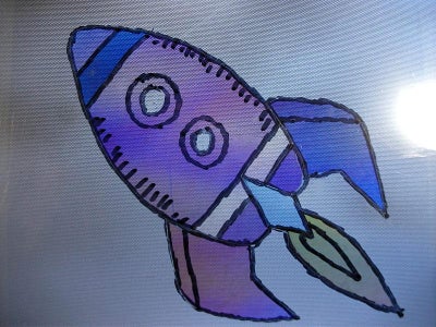

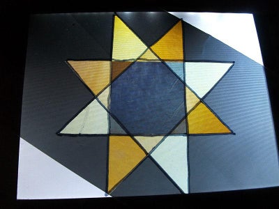

It's easy to simply place tape over the area you wish to colour in, and then trim it with a craft knife. And as you saw in step 2, simply add layers of tape to get different colours. It can be a bit tricky to add layers, then remove the unwanted tape without accidentally removing a previous layer, but practice makes perfect.
Step 4: The Final Result

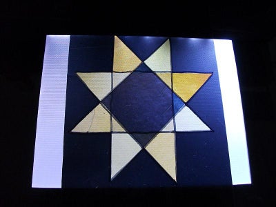

And here is the final result. As you can see, turning the filters changes the colours across the whole design.
I originally started this project using clear packing tape, but many different clear plastics exhibit similar effects. You might want to try it; find different clear plastic items around the house and see what they look like between the filters.
