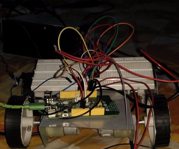

Step 2: Connections
TCS3200 Colour sensor pins to LinkIt One Board
S0 = D8
S1 = D9
S2 = D12
S3 = D11
Out = D10
OE(Enable Pin-Active Low)=GND
Step 3: Compiling the Code
Upload the code on the LinkIt One board and Run it.
You have now successfully Interfaced TCS3200 Colour Sensor with LinkIt One board and will be able to detect desired colour.
