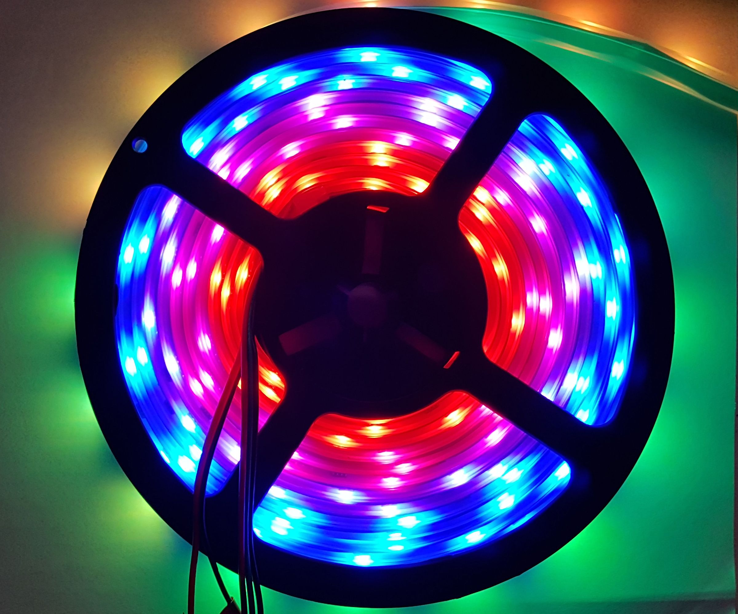

Step 1: Equipment
- Raspberry Pi - I used a Raspberry Pi 2B that I had laying around, but you can get a Raspberry Pi 3 Starter Kit for around CAD 100
- RGB LED Strip Light - I was playing with Minger LED Strip Light 32.8ft/10M 600leds RGB SMD 5050. This comes with a controller and a power supply for about CAD 40
- Barrel Jack Connector - I bought one from my local electronics shop, something like this. Just make sure if fits your power supply
- Jumper Connectors / Wire - I had some Female to Male connector cables and some 22 Gauge Solid hook up wire lying around
- Breadboard Solderless Prototype PCB Board - something like this
- 3 x 10kΩ Resistors
- 3 x N-channel MOSFETs for controlling the LEDs - I bought some IRL3303's from my local electronic shop. It's important that the gates threshold voltage is a max. 3.3V so it can be driven by the RPi pins; usually denoted by an 'L' (Logic-Level) in the name.

Step 6: Wiring Up the Circuit
Powering the LED strip
The LED strip is powered by 12 volts. The Raspberry Pi is only capably of outputting 3.3v or 5v and is not capable of outputting anywhere near the amps needed to drive so many LEDs.
It is important to not connect the 12 volt power supply to the Raspberry Pi. N-channel MOSFET transistors are used to separate the 3.3v on the RPi pins and the 12v of the LED power supply.
The MOSFET has three pins Gate, Drain and Source. If you are not sure about which is which google for the data sheet of the transistor you are using, e.g. IRL3303
We are going to connect the Raspberry Pi Pin to the Gate, the LED wire to the Drain and a common ground to the Source. When the Pin goes high, the voltage between the Drain and the Source will activate the Gate and will connect the gate to the Source.
We are also going to put 10kΩ Resistors across the Gate and the Source, so that when we the RPi pin is high, we can protect the pin by reducing the current going through it.
Carry out the next steps at your own risk. I take no responsibility for anything that may go wrong.
There is a fritzing image and a photo of the actual circuit above.
I would recommend doing this while the power is off for the RPi and the LED strip
Set up the transistor circuits, one per colour channel
- Insert one of the transistors into the breadboard as show in the diagram
- Insert one of the 10kΩ Resistors across the Drain and the Source pins of the transistor. This is the first and last pin
- Use some wire to connect the Source pin (last pin) to the ground on the breadboard
- Repeat steps 1 - 3 two more time, so that you have three sets - one per colour (Red, Green and Blue)
Connect the RPi pins to the board
- Connect Pin 16 to the Gate Pin (first pin) of the first transistor - This will be the Blue LED channel
- Connect Pin 18 to the Gate Pin (first pin) of the first transistor - This will be the Red LED channel
- Connect Pin 20 to the one of the Ground lines on the side of the breadboard
- Connect Pin 22 to the Gate Pin (first pin) of the first transistor - This will be the Green LED channel
I have used matching wire colours to the LEDs: Blue, Red and Green. I have used black for the ground
Connect the Barrel Jack
- Connect a white wire to the + end of the barrel jack
- Connect a black wire to the - end of the barrel jack
- Connect the black wire to the same ground line on the breadboard as the RPi Pin 20 was connected to
- Connect the white wire to the + line on the breadboard
Connecting the LED strip
My LED strip came with a connector that was a good enough size that it could be temporarily plugged into breadboard. I Pushed the connector in the breadboard and wired it to the test of the circuit.
- The first transistor connected to Pin 16. I ran a blue wire from the Drain pin (middle pin) to the blue wire on the LED strip connector
- The second transistor connected to Pin 18. I ran a red wire from the
Drain
pin (middle pin) to the red wire on the LED strip connector - The third transistor connected to Pin 22. I ran a green wire from the
Drain
pin (middle pin) to the green wire on the LED strip connector - Finally, I ran a white wire from the + line on the breadboard that was connected to the barrel jack, to the white wire on the LED strip connector.
Power
After checking the circuit, you should be good to power on the Raspberry Pi and plug in the 12v supply to the barrel jack.
