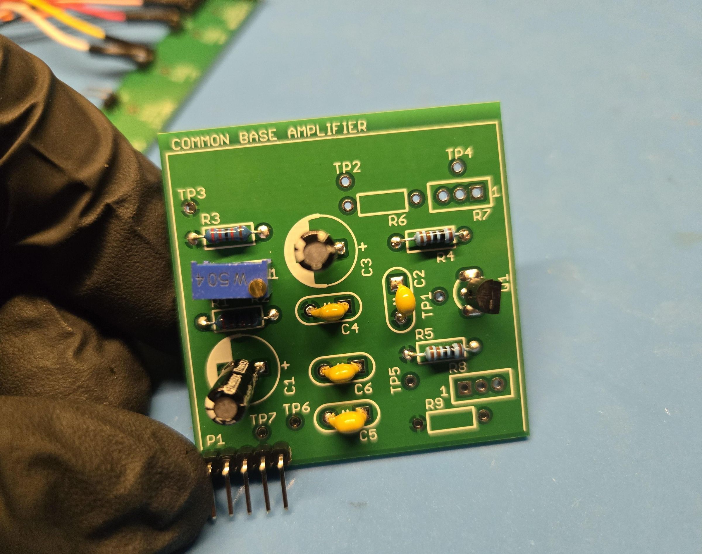

The part number on the board is wrong. The correct part number is 06A-15. This will be corrected in the next revision.
The PCB is a two layer board, and designed to be easy to manufacture and assemble. And it is optimized for cost by being panelized on 100 x 100 mm squares.
Signals are routed on the bottom layer (the layer with the part number), and a common ground plane (as uncut as possible) is on the top layer.
The P1 connector is located in a standard position with respect to the board edges: making it possible to build a universal tester, backplane, or stand.

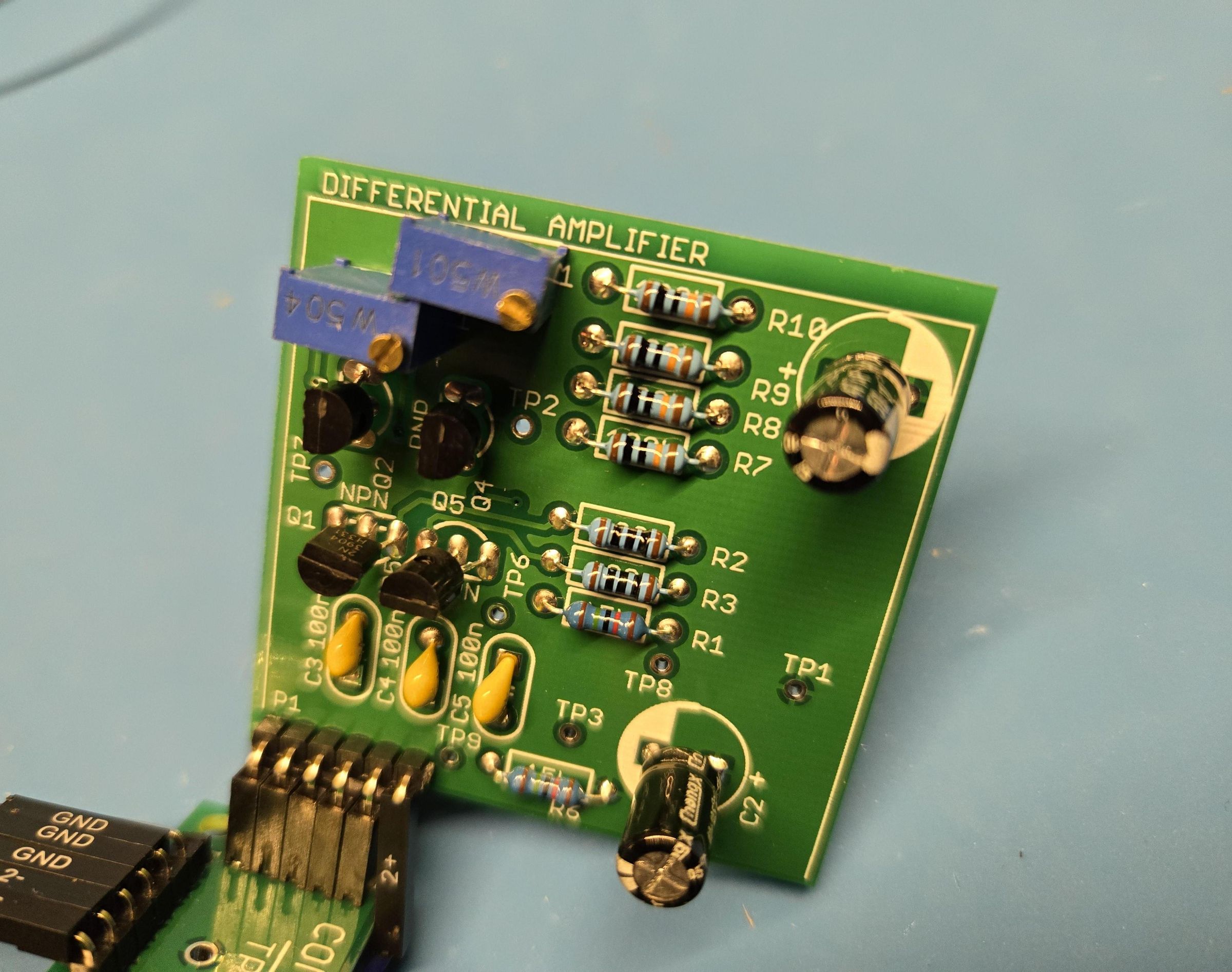

Step 3: Test Using Analog Discover 2/3
Note the outputs are not inverted, and one is stronger than the other. And the smaller signal has less distortion.
For ease of changing between five-pin boards, use Interface Board, 00A-12.
