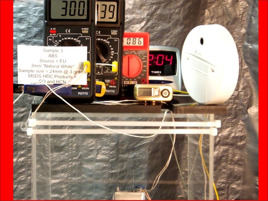

3. If you have a new 3D Printing material, there is a Safety Test Procedure for any new and previously untested material here.

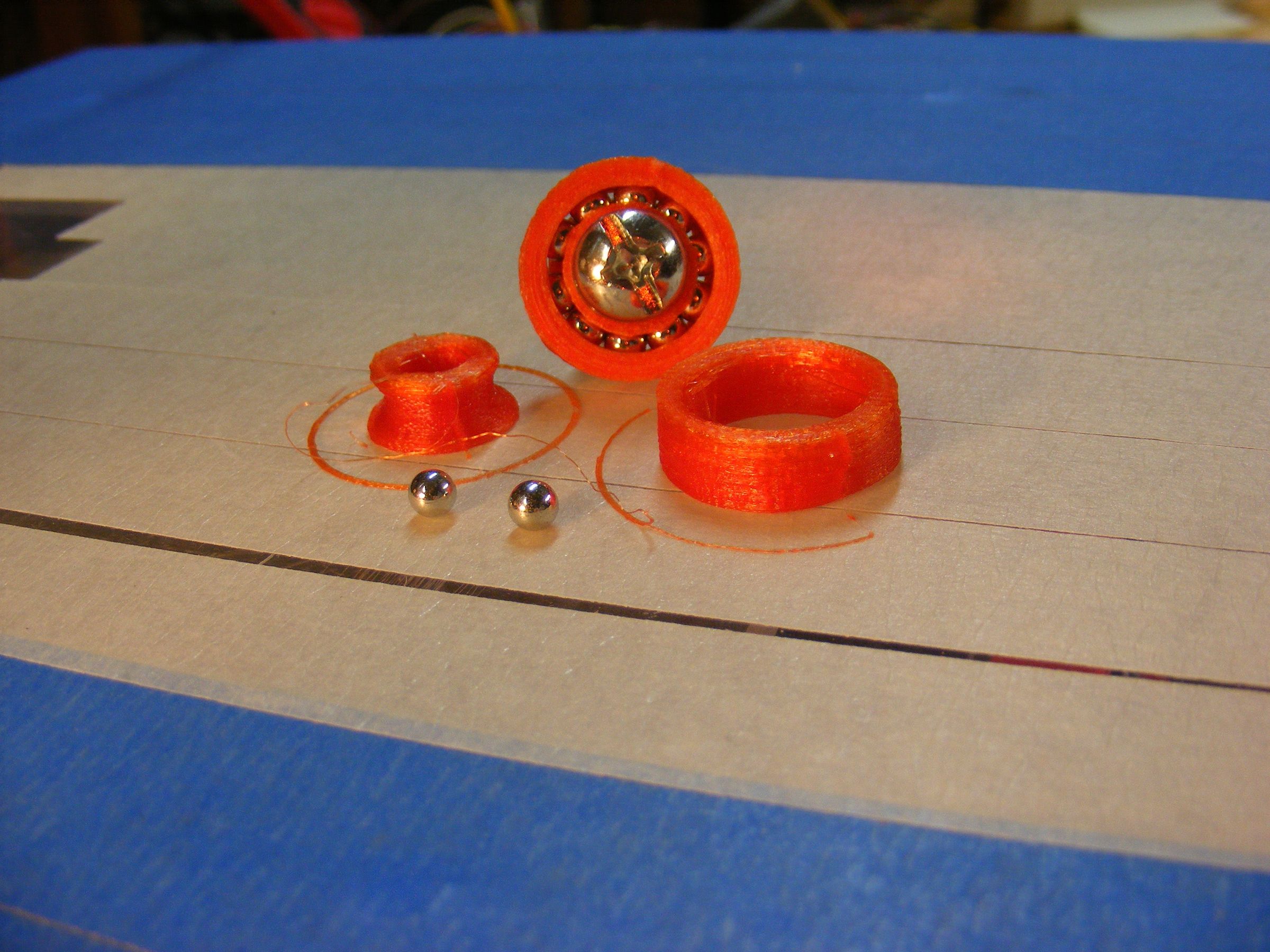

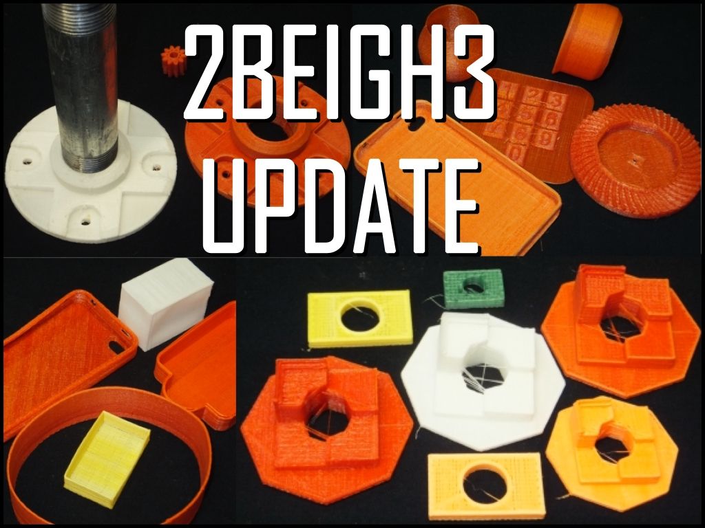

As a sample of the unique new properties of just one of these new materials, Here is a 3D Print of a Childs NYLON Prosthetic Insole on the 2BEIGH3 3D Printer.
With the 3D Printer configuration of the 2BEIGH3, you will be able to print parts that meet much higher standards for strength, flexibility and pliability. You will be able to design parts that can take 100's of severe strikes from a sledge hammer and still have a soft velvet like texture.
You will be able to print parts that are almost equal to Factory Die Extrusions. And in some cases, parts that can not be Die extruded due to complexity. The term "delamination" will cease to be a concern.
Nylon and it's derivative polymers have some great features that can be modified with fill density and layer height. Imagine being able to print a permanent coffee filter, bearings that need no lubrication, pliable IPhone cases, extremely tough bands that are so flexible you can tie them in a knot and they'll still support 200lbs!
My hope is that people use this guide to bring their designs and projects to tangible parts and objects as paper and CAD designs are great, but unproven, till built.

NOTE: 3D Printing with these plastics is just like cooking on an open stove.
Never let things get to hot.
Vent all odors and fumes.
Don't touch the electricity.
NOTE II: Polycarbonate can become unstable at very high temperatures.
There will be a separate instructable for 3 D Printing polycarbonate and it will describe a PWM controlled heater for the Hot-End. The PWM controller will have a top limit for temperature. Please do not try to print Polycarbonate with the released design. Polycarbonate can change state from a plastic to a crystal foam that easily catches on fire if the hot-end temperature exceeds 400C. Well above printing temperatures.
Because these fumes emanate from the hot-end's thermoplast area (About the size of a pencil eraser) the actual amount of fumes is quite small. Something along the line of a standard cooking stove vent is sufficient as long as it's in a position above the hot-end to capture odors and fumes.

Step 14: 2BEIGH3 3D Printer Overview
We consider CNC machining to be "subtractive manufacturing" or "subtractive build" method. We start out with a bar or slab of material and cut off what we don't need, tossing the remains away. While you can make 3D like objects, there are still limitations. There will be scrap on the floor as unusable material.
The 3D Printer is "Additive Manufacturing" as we take a constant source of material and force it to a desired shape. Nothing is wasted.
The 2BEIGH3 3D Printer uses the same operational principles as most other current X-Y plastic extrusion printers. Again, the main goal was for a combination machine that could quickly be configured for CNC - 3D - CNC.
A major benefit of the 2BEIGH3 is that the hot-end ( the component that heats the plastic) and extruder (the mechanism that pushes the plastics rods into the hot-end) are designed for more than just ABS or PLA. They are also designed for NYLON and other polymers. NYLON has a ton of features I want everyone to experiment with in the design of new parts that can take advantage of it's properties. I have provided an MSDS for NYLON for those interested.
There are of course differences in how we print with NYLON as opposed to ABS. One of the main differences, is that we will "melt" ABS, PLA and PET but we will "cold extrude" Nylon, Nylon polymers, Acrylic and polycarbonate. Of course, the Tighter polymers like Nylon are not really cold, but they are not melted either. And this is where the high "pushing power or compression capability" of my extruder is required. This is also why retraction isn't advised as the pressure is large enough to make it difficult to completely relieve by simply pulling the material back.
When you learn how to print with NYLON, I am sure you'll be pleased with the final results.
And I'm sure you'll find, like I did, that the major key to parts printed in Nylon and Nylon polymers is that it's tight bonding literally eliminates "de-lamination"!
Going just a bit deeper at this point....We can control the "density" of the internal fill of printed parts from within the software. NYLON is very pliable as you know, so we can literally change the hardness/firmness/tensil strength of a part by changing it's fill percentage. Want a small keyboard button overlay for a control box.....fill at 25%....want a bearing that has a bit of give to reduce vibration.....fill at 50%...want a hard almost UN-bendable lever....fill at 100% and so on.
For those familiar with 3D printers, here are some differences when printing with NYLON.
I'm sure you folks can teach me a lot more about 3D printing and I appreciate your comments.
Nylon welds to Kapton. (Kapton tape is a super high temperature rated tape for heating appliances.)
The tiny threads left behind can not be removed with acetone as NYLON laughs at acetone.
I hit the part with a propane torch for about .3 sec to burn the threads.
NYLON will absorb water, so keep it dry when not in use or it will add blemishes to your prints.
If your hot-end isn't mechanically tight, the NYLON will find a place to leak out.....makes a mess.
NYLON strands from printing are not a fire hazard.
Nothing glues to NYLON except other melted NYLON so if you need multi-part assemblies, they should be designed to be held together with hardware.
NOTE: Some of the photos of the Child's Insole are very high resolution.
As noted in the previous videos, the flexibility and pliability of parts made with Nylon and similar polymers opens up a whole new group of possible parts and their usage.
It's also important to point out that one of the major complaints of parts printed in ABS and PLA, is lack of strength or mechanical structure. Even today, some kits come with instructions to have the end user print a series of replacement parts for the 3D Printer they've just purchased.
The very nature of 3D printed parts means that all parts rely on the attachment of each individual layer to the last layer.
One of the major benefits of printing with tighter polymers like Nylon and it's chemical relatives, is the extremely tight bond from one layer to the next. In reality, while these parts may look similar to parts printed in ABS or PLA, their mechanical strength and structure is, in some cases, almost that of a Die Extruded part.
So those currently building a 2BEIGH3 can see the strength of their future parts, I am posting the next video.
This is a preliminary video made by one of the technicians as the samples I've submitted are not scheduled to go through full test for another month. The technician sent me three short videos, two each at 320 frames/sec and one 180 frames/sec. In these videos a sample of polymer 618 (my part number) is struck by an 8lb sledge hammer.
For those of you that will want to build tough parts, you'll want to take a min to watch.
Even if you're not ready to build a 2BEIGH3 just yet, please take a moment to watch the videos.
With the excellent input from others that have contributed to blogs, postings here on instructables, comment sections and product reviews all over the web, It is my hope that you find the 3D Printer configuration of a 2BEIGH3, helps us all to put the
"Disruptive" back into a "Disruptive Technology".
