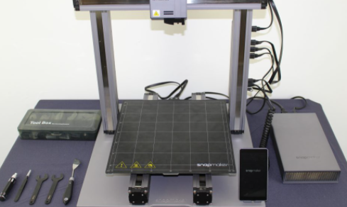

Step #1 Fire up your 3d printer put in whatever filament colors you want
:download the files given
:send it to the printer
:start printing

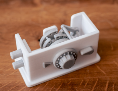

Step #2 Assemble all of the parts as shown in the image and boom you have a functioning combination lock safe
For the assembly it is best to build the lever first. Connect the two levers with their short arms and the "safe_leverShaftShort" to the "safe_sled" than put the second "safe_leverShaftShort" through the long arms of the levers. Put the assembly in the "safe_case" and push the "safe_leverShaftLong" with the "safe_leverHandle" on it through the case and the middle hole of the two levers. Push the two "safe_sledRod" through the sled and the holes of the case, they are the locking bolts of the safe. The "safe_disk1" goes with one "safe_spacer" through the case and gehts connected to the "safe_dial". The three pins are inserted in different positions (this creates the combination). "safe_disk2and3" together with the two spacers are going on the "safe_shaft" wich is going to be mounted to the "safe_shaftHolder" with the "safe_shaftHolderBrim". Last step is to insert the shaft holder with the shaft into the slot an the bottom of the case and glue the "safe_indicator" next to the dial in place.
