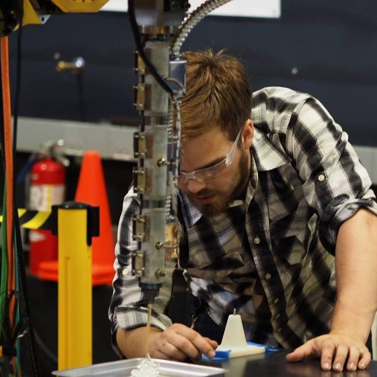

Introduction: Combining Additive and Subtractive Manufacturing
Anyone who has used a 3D printer has faced the reality that it is not an exact science. Parts can turn out misshapen, or fail to print all together. It was this frustration that has inspired my partner and me to spend the last 4 years developing and experimenting with how we can make better parts, bigger parts, or make them faster. Our first attempt focused on “better” parts, the idea that by using traditional subtractive technologies we could refine parts to have high tolerances and pristine surface finishes. This is how we set out to accomplish that vision.
