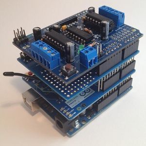

Step 6: Using Arduino Shields to Simplify Adding Hardware Complexity
Orderly consolidating sketches or using functional abstraction are methods to deal with software complexity. But usually when you move from simple, independent Arduino modules to Arduino systems that combine multiple functionalities, the hardware also grows in complexity. In many cases this can be dealt with just by adding more components, as long as you resolved hardware conflicts, like using the same pin more than once. But some cases require multiplicative complexity, such as adding 5 copies of a relay driver, 3 steppers in an arm, or 2 motors in a car. Other examples might be when adding one new component requires much more complex circuitry, such as a radar sensor. One possible solution to these problems has evolved in the Arduino world called Shields.
Arduino shields are modular circuit boards that plug on top your Arduino PCB to extend its functionality. Each shield has a specific function. One of the features of Arduino is the use of breadboards to enable you to easily construct circuits. This is fine for prototyping, but they can become clumsy as the complexity increases or you want a more finished and durable project product. Shields provide a solution to this problem.
Here is a short, basic list of useful shields: Motor Shield, Ethernet Shield, GPS Shield, JOY Stick Shield, Relay Shield, Motor Shield, Relay Shield. The list is endless and constantly growing. The best reference is to do a web search mentioning "Arduino Shield XXXXX". Where XXXX is the functionality you are looking for.
