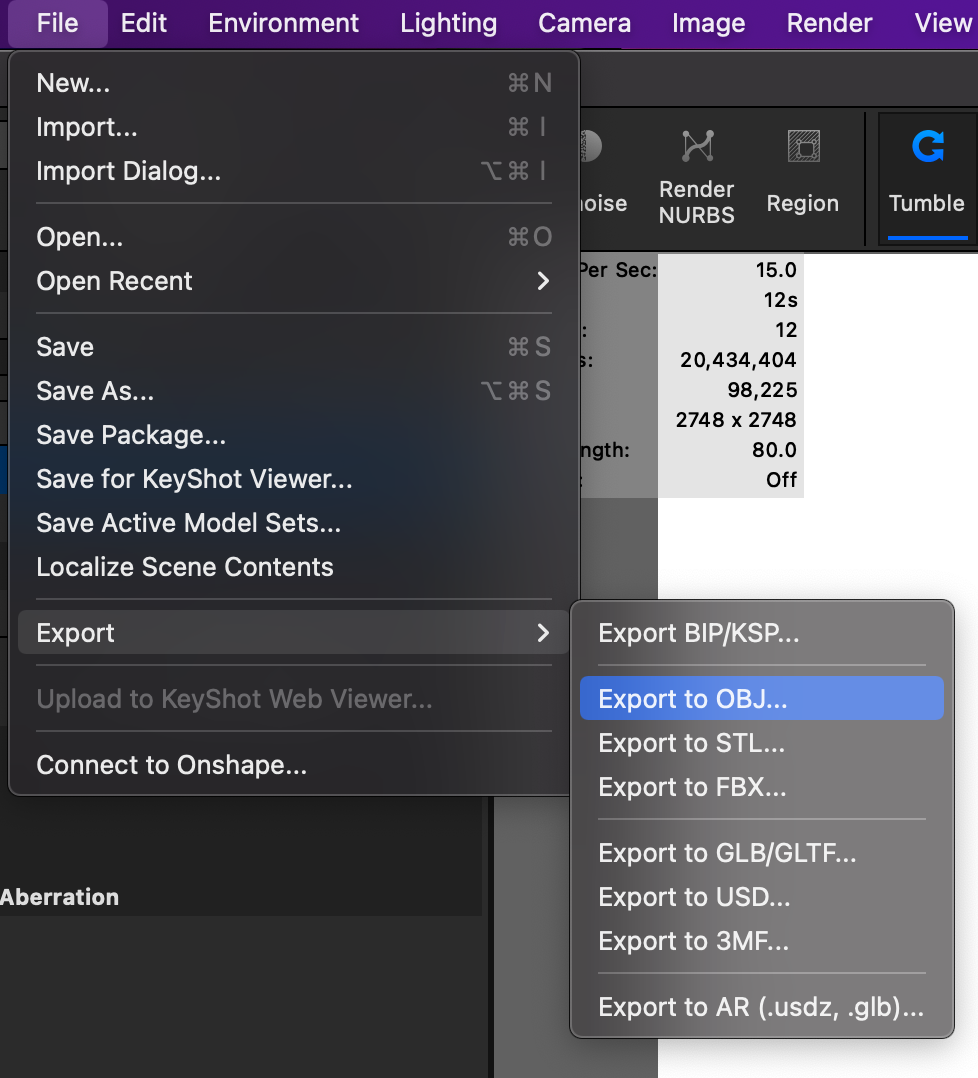

Step 2: Export OBJ
Keyshot lets you export what's visible in a scene as different 3D model types. With only the parts visible that you want to combine, select File>Export>OBJ (OBJ retains certain metadata we want to keep)
