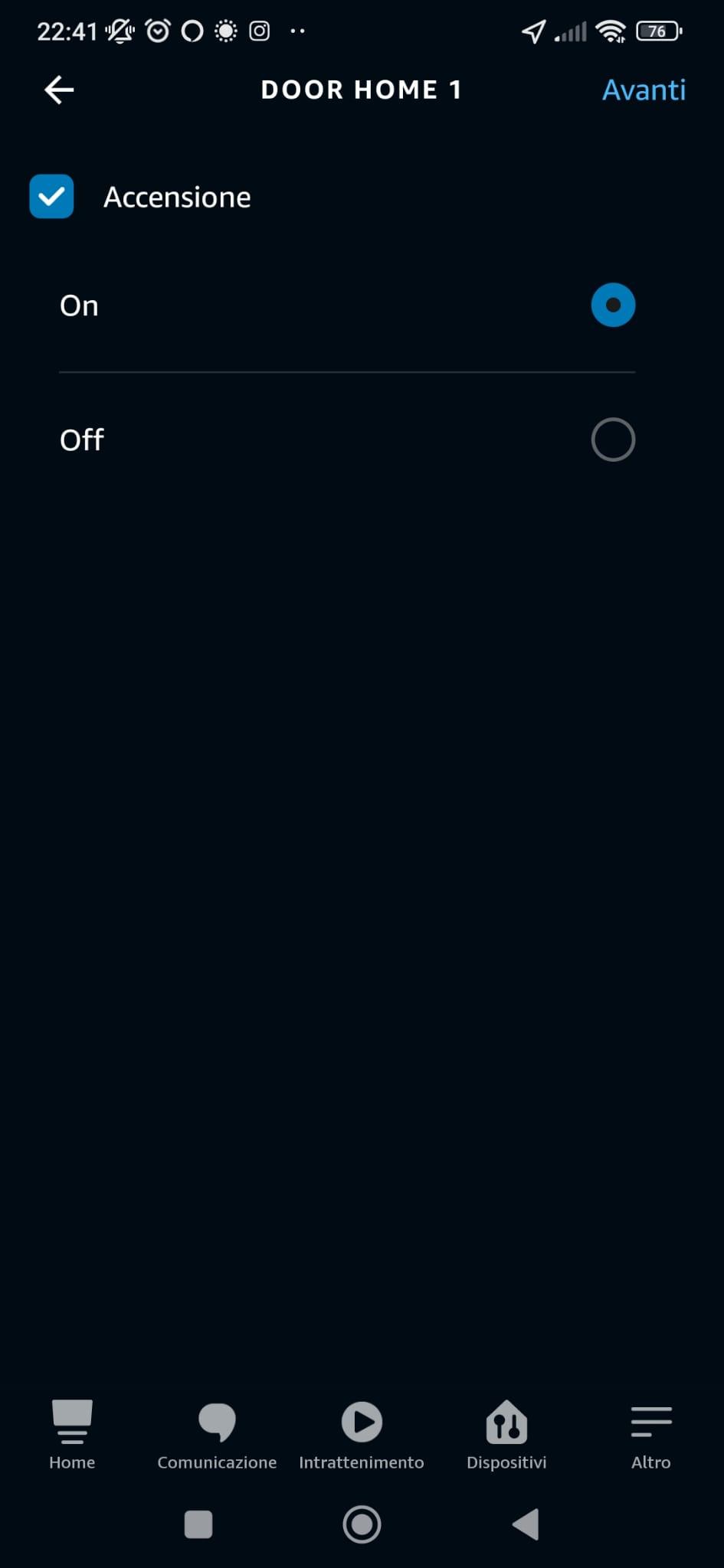

Step 4: Alexa Skill - Voice Commands
Install the Alexa skill to send requests to Nod-RED using voice commands, see attached screenshots. The steps to set up the Alexa skills are the following:
- In "Other" → "Skills and games" search and install the skill "Node-Red" as shown in the picture;
- Enable the Skill and enter the Username and Password;

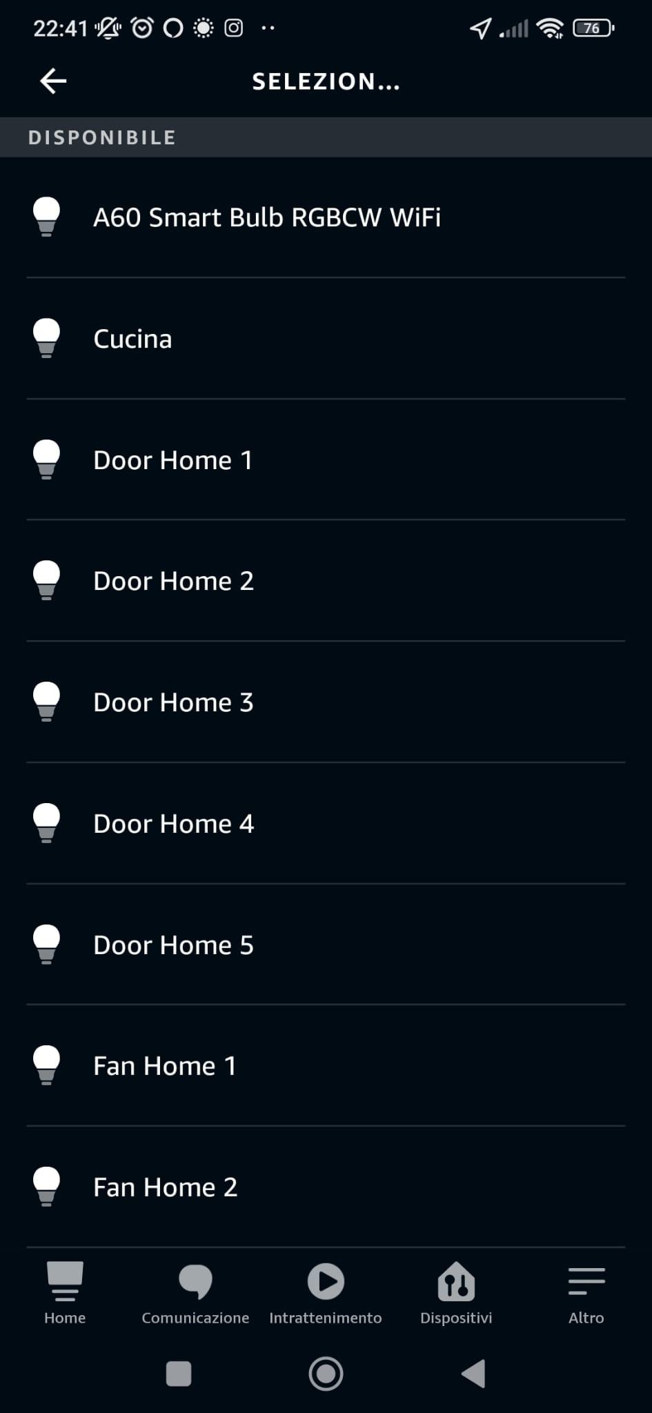

- Alexa will automatically search for new devices, alternatively in "Devices" → "Your Devices" you can find and add new devices created on "https://alexa-node-red.bm.hardill.me.uk/";

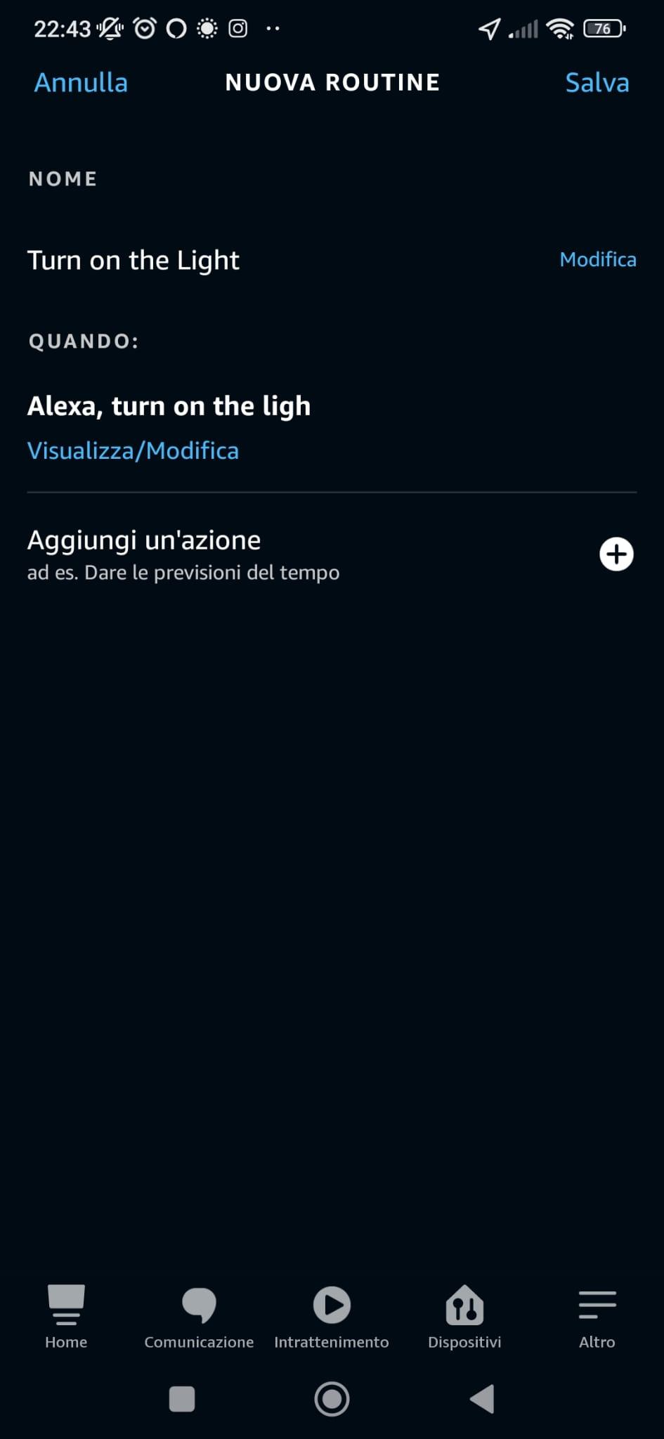

- We can change the activation or deactivation command of a device by going to "More" → "Routine";
- In "Routines", add a new one by assigning a name, a trigger command in the Entry menu, and an action; In the Action menu select "Smart Home" and the device.
