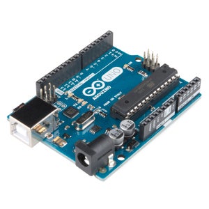

- Arduino UNO (any other will do as well)

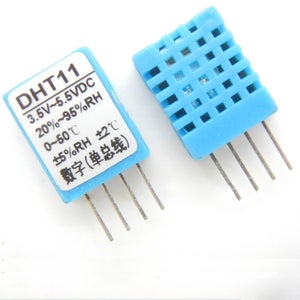

- DHT11 temperature and humidity sensor

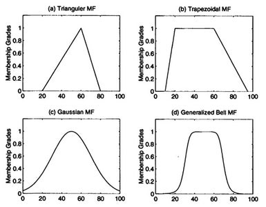

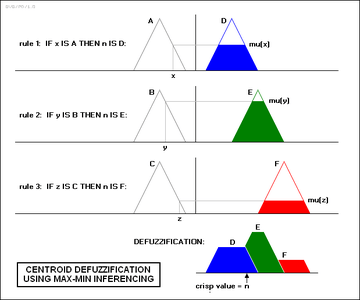

There are three stages in fuzzy logic: fuzzification, prediction and defuzzification. First something about fuzzification. Fuzzification is process with which we calculate affiliation of input variable to a certain fuzzy populace or membership function. There can be many different shapes of membership functions: trapeze, triangle, Gauss,… In prediction stage we are using pre-determined set of rules (those are set by designer) to predict what the output can be or to which membership function output variable affiliate whit what level. This numbers cannot be used as they sits. In the third stage, defuzzification, we can combine all the levels of affiliation to only one value. This process is also called sharpening of output value. Single output value can then be used in further processing. More about fuzzy logic.

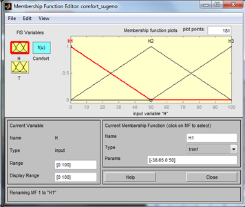

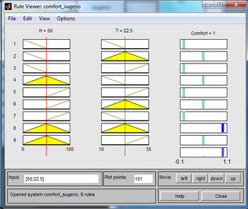

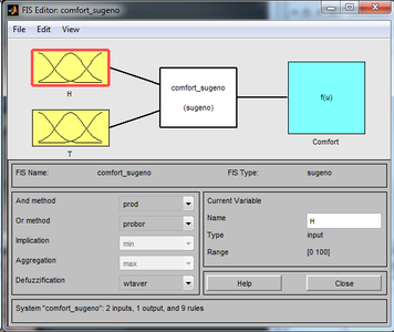

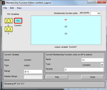

Soft sensor is designed in Matlab using Fuzzy Toolbox and then implemented on Arduino. We have designed Sugeno fuzzy system with singleton output variables. Fuzzy sets of input variables and output variable with membership functions are presented in pictures above. There are two input sets with three membership functions each: temperature and relative humidity. We’d decided to use triangular membership functions. Output set Comfort consist of three singleton membership functions: very uncomfortable (u1 = 0), uncomfortable (u2 = 0.5), comfortable (u3= 1). We have designed set of 9 rules to determine atmospheric comfort and are listed in pictures above. Defuzzification output will give us a number between 0 and 1 (because it can later be simply calculated to %). We tested designed system in Matlab, results are presented in pictures above.

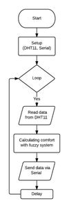

Although a fuzzy logic library exists for Arduino, we decided to write our own code. Code is mainly copied from Matlab and it is well commented. Flow diagram is added above (in pictures) for easier understanding.

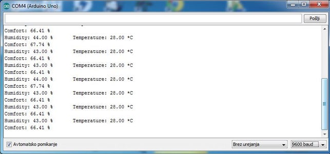

Soft sensor is working as it was designed.
