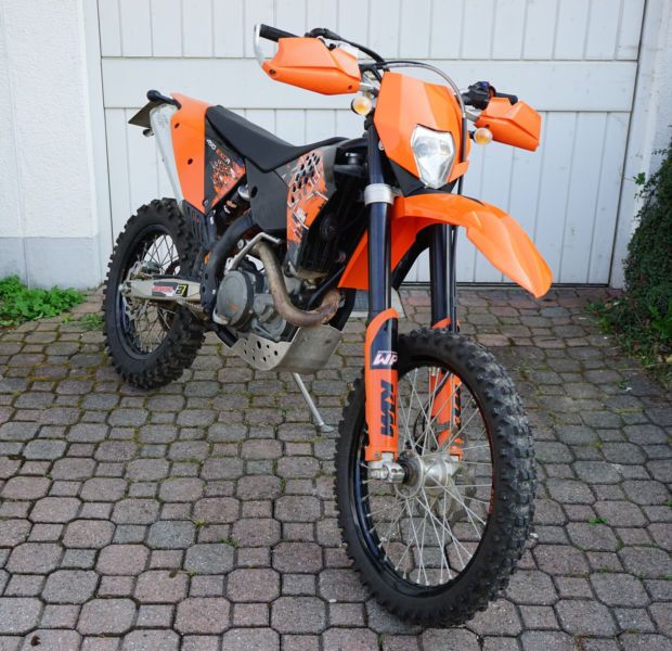

I like to use my Enduro Bike, KTM 450 EXC-R, for trips through the mountains. For one thing, it is very light and powerful and for another, it can be used on and off the road.
The first 2 trips were no fun, as after about 2 hours my lower back was hurting and burning. The seat is only 4 inches wide and quite hard, thus only a part of my rear could rest on it.
So a fix was needed. Here I describe how I fixed this problem.
Now I can ride the bike for hours without any problems to my lower back.
