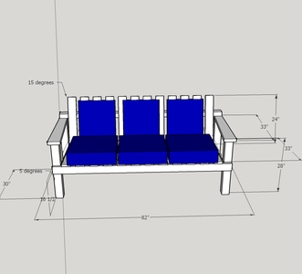

Step 1: Cushions
The first thing I needed to find was cushions then I could design the frame off the cushion size. Target was by far the cheapest for the size and color choices I wanted which for the seat cushion is 24" by 22" by 6" thick for $26. The back was 20" by 18" by 3" for $15.

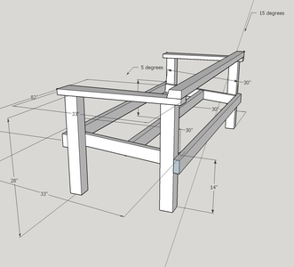

Step 2: Design
If you wanted a 4 or 2 cushion length couch this is where you can make that change, customizing it however you want it but use the cushion sizes to design it. The most important thing about this couch is not the size but the 5 degree slope and 15 degree back angle, that's what makes it really comfortable. Now that I had the cushion sizes I could design the frame. So I decided to use Sketchup, which I've never used before but I will now for any future project. It really helped visualize problems before I even purchased the materials. The key to a comfortable couch or chair is angles. The seat part was around 5 degree slope and the back around 15 degrees. If you ever sat in a perfectly flat bench or chair you'll know exactly what I mean, you need to put some angles to make it really comfortable.

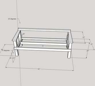

Step 4: Construction
Predrill holes to prevent splitting wood especially on the 1" by 4" slats.
I cut the 10 foot (4" by 4") at 28" for each leg. If you want a shorter overall couch this is where you trim off another inch or two, so 27" or 26". Then cut 2 of the (2" by 4") at 82". Using 2 1/2" screws, attach one of the 82", (2" by 4") to the front of the post 16 1/2" up from the bottom of the leg, that's the front of the couch. Now attach the 2nd (2" by 4") to the other 2 posts, (4" by 4") at 14" up from the bottom of the leg. That should give you about 5 degree angle. Take another (2" by 4") and cut 2, 30" pieces with a 5 degree angle cut on each end, make sure that it is cut correctly on both sides so you have that 5 degree slope. Screw those pieces together to make your main frame.
Now the arms. I cut the (2" by 6"), 5 1/2" on one end and 3 1/2" on the other to give it a flare out but you can leave it a solid (2" by 6") if you want. Cut a (2" by 4"), 72" for the extra support for the seat. I placed it 16" in from the front of the couch.

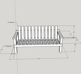

Now place the back rail. Take a (2" by 4"), and cut it to 82" and I put a
15 degree rip cut. You could use a table saw but i just clamped it down and used a circular saw with a guide.
Next up was the (1" by 4"), strips. The back slats were 24" and the seat slats were 33". On the 24" slats I cut a 10 degree angle on one end (15 degree - 5 degree=10 degree) so they would fit flush against the seat slats. I had 12 that I spaced evenly. I used a method that is used for the spindle spacing for a railing or you could just eye ball it because the cushions will cover them up. Roughly 3" spacing, just make sure that the back strips and seat strips line up and it will look good even if the spacing isn't exact. I attached the strips of (1" by 4"), with the 1 1/4" screws just make sure you predrill the holes to avoid splitting the wood. Attach the seat slats first then the back slats. Attaching the slats for the back I layed the slats against the back rail 15 degree rip cut to get the angle but I also used my phone and a level app to check the 15 degrees. I cut the (2" by 2"), board so it was the same length as the farthest slats at 72". I layed it on top of the seat slats and attached it from underneath with the 1 1/4" screws.
