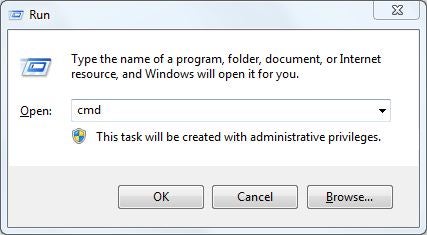

press ctrl+R and write cmd then press enter.
now a in command propt write command

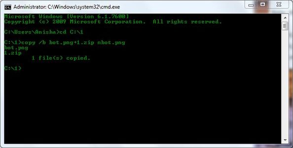

now write command
copy /b bot.png+1.zip nbot.jpg
here bot.png is name of image
1.zip is name of the zip file we made in step 1.
nbot.png is name for image to be created with hidden files
