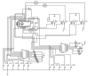

Step 1: Electronics Side: Meeting the Boards
Fore Word: First of all will be started with boards. Above schematics show all the circuitry. I have limited understanding about Proteus. Therefore for testing purposes i draw all the circuitry on one file. Please ignore voltmeters as they're there for debugging purposes. PCB layouts are drawn seperate files. Above, you can see images of them. I couldn't be able to upload proteus project files.
Complements: We have 2 different boards. Main controlling board, which does all controlling. And a daughter board, which controls buttons. With this design we won't be messing around with cables. (much :) )
PLEASE NOTE: This project doesn't control tank water level. This circuit especially work with existing control unit of the machine. This project is designed with the intention of being auxillary control, it can be powered down and the machine can be operated with its own buttons.
About buttons: Because of my lack of better judgement, this project uses individual buttons that mounted on the frame of the machine. Buttons are rgb backlit that uses 12V supply. Hence this project needs both 12v and 5v power supplies. About ULN2003A's, they are solely for driving button's backlights. With 5v lights, you can ignore them and redesign. But for the sake of reliability, i recommend using them.
About relay board: My machine controls 3 things with 2 buttons cleverly and simply. These are water pump electrical wiring, and group heads' solenoid valves. So i wired my 4 channel relay board's 3 relays to the buttons.
On final note, i'm not professional. I couldn't write the code elegantly, and couldn't install on the machine elegantly. I lacked professional tools to do so.

Step 3: Mounting the Electronics
Power supply: 5v ac-dc and 12v ac-dc modules. They are entering the board from different places. Honestly i can't remember how did i make it work. There were lots of ierations and debugging went on. My machine electrical connections splits into two different sections. One is directly responsible for resistant heater inside the tank. Other one is controlling solenoids and water pump. I got my ac supply from this circuit. My machine uses rotary switch with two settings for powering on. First setting only activates existing mcu for tank level control purposes. So machine can't run without water. After a while if everything is okay, then you switch one more notch so machine can go brrrr :)
Relay board: I mounted the relays to the back of the machine cause there was empty space. Im using 3 relays to control the buttons. 2 for solenoids and 1 for the pump.
Buttons: I'm a bit embarrased that i used single buttons for this prototype. All it managed to do was making me nuts, and looking ugly. Buttons are mounted on the detachable front frame. 4 wires come off from each button and they're connected to daughter board. The daughterboard is also mounted to the same frame. 2 boards are connected with each other via ribbon cable. It is the only neat thing about it. :) For each group there are 5 buttons - 4 are programmable, 1 is start/stop - and one calibration button that controls both groups.
Controlling unit: Main board is located at the left bottom corner on the machine. It is wrapped with nylon bag, making it IP66 compliant :D. For temporarily. After a while i 3d printed nice black box. After that i made the connections according to the schematics.
Step 4: Switch Snubbing
Everything works, but when you use the machines old buttons, suddenly everything go hay wire? Yeah this is the reason. Since water pump is inductive load, when pump shuts off it creates transient currents. So this little contraption snubbs these transients.
I used 1M 5W resistor and 300nF 400v capacitor with this formation. As you will researched online, there many ways to cancel out transient currents. This one worked for me, but your mileage may vary.
