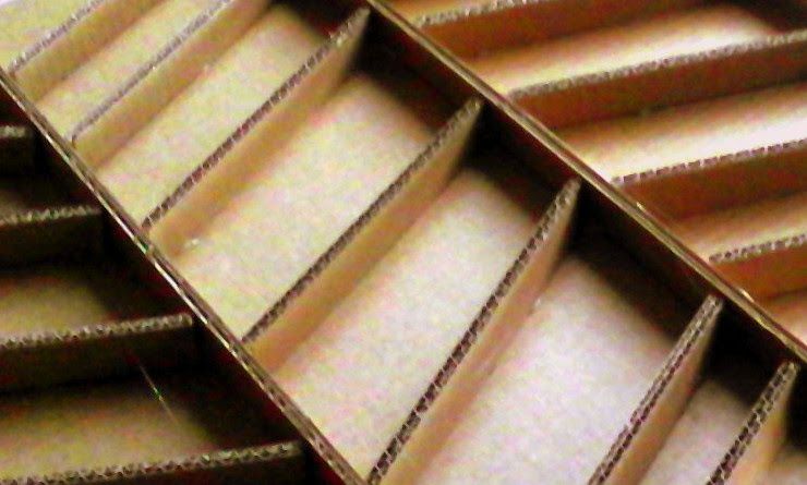

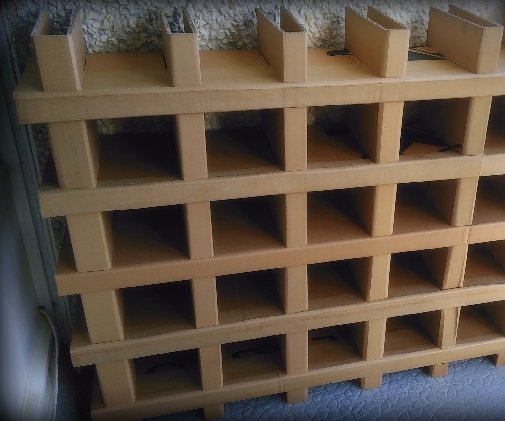

Step 4: Cut Crosspeaces
You have to make notches in the intermediate cardboard, about every 10 cm
Then you have to draw and cut the crosspeaces like the picture.
It's important to make your furniture very strong.
Step 5: Place and Stick
Place every crosspeace on the intermediate's cardboard and stick them with the glue gun.
You have to verify that everything is perpendicular with the square tool. It's important !
Then, you will cut pieces of cardboard to put inside every recess.
Keep on your mind that the chest should be perpendicular...
