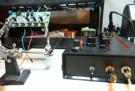

This is an old project of mine from about 3 years ago. I was 8 when my father bought me a C=64 28 years ago, and I still remember how thrilled I was to play with it (I'm still a gamer and a hardware hacker thanks to it), and the main thing for me in most games was the epic music. So after many years, I decided to make a little synth based on the famous MOS6581. I lost my patience when it came to creating the patches (instruments made from using separate oscillators at different settings and times).
So this is a basic module you can experiment with, it allows you to play with the raw register values (but there's also the code for using it as a programmable 16 step sequencer, or a MIDI controlled synth).
The circuit consists of a MOS6581 (from old C=64s, the ones I got from e-bay had faulty oscillators, but I got a refund), a PIC18F452 (the brain), 2 shift registers (to be able to communicate with the SID serially, using the 8 data and 5 address lines), a 4x16 character LCD for display, a MAX232 for serial communication with a PC (never really used it for a purpose other than bootloading the firmware), an optocoupler for the MIDI input, a LM386 for direct audio output, linear regulator ICs, some connectors, switches, and pots.
