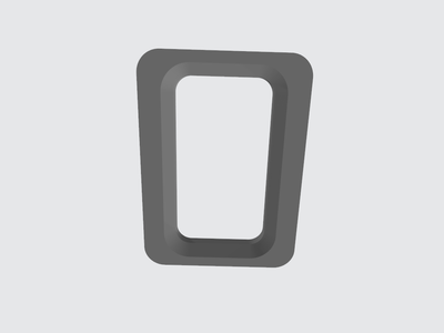

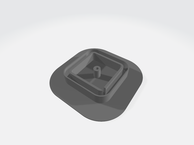

My Datasette had a faulty board that was removed previously so I only had to cut a piece of mechanics in order to make more space inside. Also old tape tray was cut out and new one was designed and 3d printed. On the right side I cut a hole install oled display. Frame with curved corners was also 3d printed. I had to change the way how the cover of the tape is opening because sata drives have their pins on the side. I cut the old hinge and sides of the tape cover to make it flat. I drilled two small holes on both sides of sata plug and I used screws to install it on new tray. Sata connector works as hinge from now on. I used hot glue gun to stick tape cover to the sata hinge and to attach new tray underneath of Commodore top cover. Same for the oled screen and the frame. To control oled screen I used esp32 board flashed with Esphome. I wanted to make Commodore looks like it's floating so I printed support stand with a slot for LED strip that is also controlled by the same esp32.
