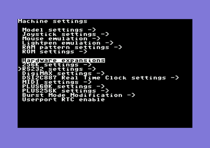

Step 3: Teaching VICE to See the Virtual 2400 Baud Modem
Let's dig below that bright blue screen into the VICE settings.
Press F12.
Use the cursor keys to arrow down to "Machine Settings" and then arrow right.
Cursor down to "RS232 Settings" and then arrow right.
Arrow down to "Userport RS232 emulation" and press ENTER to activate. It'll display an asterisk *
Arrow down to "Userport RS232 host device" and select 4. (Use left arrow to go back)
Arrow down to "Userport RS232 baud rate" and select 2400. (Use left arrow to go back)
Arrow down to "Device 4 baud rate" and select 2400. (Use left arrow to go back)
Now, here's the very touchy part.
Arrow down to "Device 4 ... " and press ENTER.
Carefully delete the entire line EXCEPT for the British Pound Sign, then add
nc 127.0.0.1 25232
Compare all of your changes with image 3 in this step.
Once your screen looks like mine, use the left arrow to go back to the first menu, go down to "Settings Management" and save your settings. You shouldn't have to do this again.
Settings Saved? Use "Quit Emulator" to go back to the Raspberry Pi pi@retropie:~ $ prompt.
