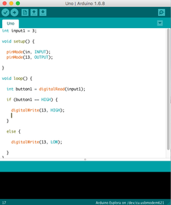

Step 2: Code for Uno
Now, make a new sketch, and copy and paste the following code. Make sure to set Tools > Board > Uno before you upload, and make sure it's uploading to the correct port.
int input = 3; // gives name to pin 3
void setup() {
pinMode(in, INPUT); // sets pin 3 as input pinMode(13, OUTPUT); // sets pin 13 as output }
void loop() {
int signal = digitalRead(input); // reads input
if (signal == HIGH) { // if there is a signal...
digitalWrite(13, HIGH); // turn LED on }
else { // if not...
digitalWrite(13, LOW); // turn it off
What this code does is check for a signal coming into Pin 3. If there is a signal, the internal LED connected to Pin 13 on the Uno will turn on. However, in order to get a signal, we will need to connect the Uno and Esplora together.
Step 3: Connect the Two
Now, for the easiest step of this whole project, connect Pin 3 on the Uno to pin 14 on the Esplora as shown in the photo above. If you did everything correctly, when you press the bottom button on the Esplora, the small LED on the Uno will turn on and off as you press the button!
