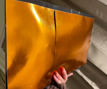

Step 2: Paint the Board
- Paint the front and back of your board whatever color you’d like.
- We painted the front of our board gold and the back black.

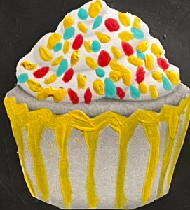

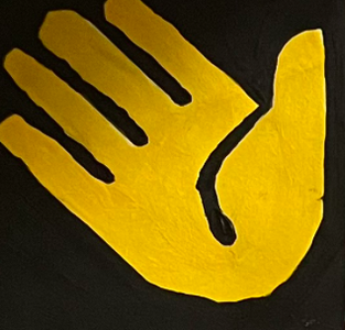

Step 3: Print the Images
- Print the images which will represent the buttons on the board. Each image should correspond to a specific message you’d like the speaker to play.
- We painted over our images to make them more textured and colorful.

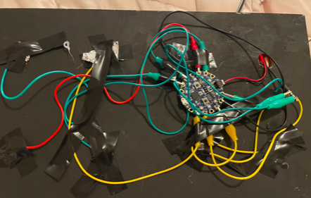

Step 6: Gluing Pictures & Alligator Clips
- Tape CPB down on the back of the board
- Glue the pictures on the board
- Attach alligator clips/wires
- One end attaches to the aluminum foil through the circle and one end goes to the corresponding CPB touchpad (view code)

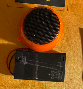

Step 7: Speaker & Battery
- Glue the speaker and the battery pack to the board (where the circle is that does not have a square)
- Feed the wires through the circle and attach the wires of the battery pack and the speaker to the CPB
Step 8: Tape Everything Down
- Turn to the back of the board
- Use electrical tape to attach the alligator clips on the back and to prevent them from getting tangled and ensure they stay in place.

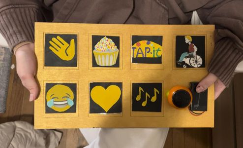

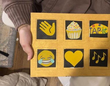

Step 11: Try It Out
We're finished! Try your board out.
