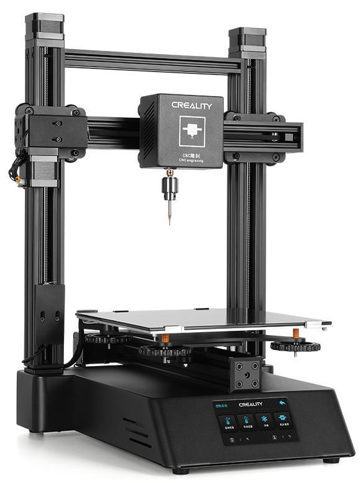

Introduction: Communication With the CNC Milling Machine Using Raspberry PI
The purpose of this project is to automate the communication process with the machine while ensuring remote access.

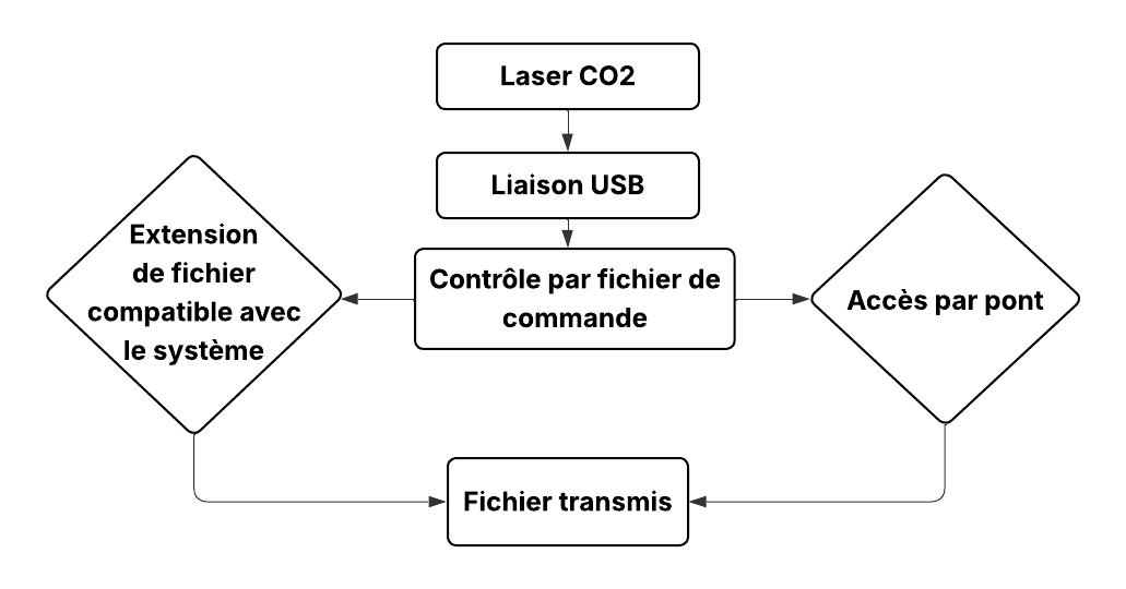

Step 1: Feasibility Study for CNC Machine Control
SWOT Analysis – Communication with the Laser Machine
Strengths
  1. Standardization: Using an HID port helps avoid compatibility issues associated with traditional COM ports.
  2. Reliability and Recognition: The Mach3 software is widely used in the industry for CNC machine control, ensuring an active community and technical support.
  3. Automation and Precision: Automated communication reduces human intervention, limits production errors, and improves task repeatability.
  4. Low Latency: The HID protocol allows rapid command transmission, essential for precise machine control.
Weaknesses
  1. Limited Compatibility: Some CNC machines use HID ports that are not natively supported by software without specific plugins.
  2. Dependency on Software and Drivers: Using Mach3 and proprietary drivers (e.g., BL-USBMach3-V22) limits flexibility and may be problematic if support ends or compatibility issues arise with newer versions.
  3. Lack of Native Support on Other OS: The system is designed for Windows, making it difficult to use on Linux or macOS without specific adaptations.
Opportunities
  1. Optimization of Operating Costs: Automating communication reduces human intervention time, minimizing errors and manual task management costs.
  2. Transition to Industry 4.0: Improved communication opens the door to integration into a connected, intelligent environment where machine management is centralized and optimized.
Threats
  1. Software and Driver Obsolescence: Dependence on proprietary software (e.g., Mach3) and specific drivers exposes the system to compatibility risks if hardware or OS evolves.
  2. Windows Dependency: Use of Windows APIs (WriteFile, CreateFileA, etc.) prevents the system from being portable to other platforms (Linux, macOS).
