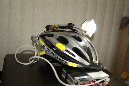

Through much trial and error on different projects, I have learned: Do not bend aluminum at a 90 degree angle. All of my bends were completed by bending the aluminum around a wood dowel so that the bend radius was enlarged as not to weaken the structural integrity of the aluminum as much as a sharp bend.
An important design consideration in my lighting system was for wrecks. Commercial systems are designed to shear off your helmet in the event of a wreck so as to minimize helmet and/or skull damage. All of my aluminum was screwed together with no more than three #4 screws to facilitate breakage on impact, but not during normal use. Additionally, Nonstructural components, including LEDs were mounted using Nylon screws to eliminate short circuits due to inadequate mountings.
Another important design consideration for my system was heat dissipation. I needed approximately 1 square inch of Aluminum inch per watt based on my readings, but I did not want a heavy heatsink up there on my head. Believe me, I have been riding for two years with three commercial lights on my helmet. It overweights the helmet and really works your back and neck on long rides. My new frame is all one big heatsink that works amazingly well.
I constructed my frame to fit my bike helmet and bent the aluminum accordingly. You will notice that my headlight does not swivel or pivot. After years of commuting, all with lights, I discovered that once I had the light adjusted, I never touched it again unless it got misaligned by bumping it on something. Bump-no-more, this light stays true to its aim.
The specified aluminum bar is easy enough to bend with your bare hands, but stiff enough to hold its shape. I drilled holes in nonstructural ares to reduce weight.
Please ignore the dirty entry rug, somehow I overlooked aesthetics while excitedly photographing my project.

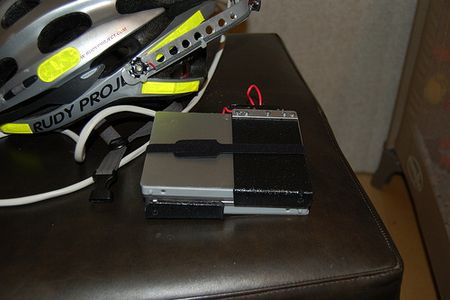

Arguably, the battery choice is the most important component. Interestingly enough, I knew my battery choice long before I had worked out the details of the lighting system. My wife has a Mac Book pro, and so do I. Between us we have two extra batteries for when we travel. These just sit in a drawer until a scheduled flight. Rather than waste such a valuable resource, I thought I would use these as my power source. As I commented in the prior step, they are Lithium Ion with good discharge capability 10.8v, measured at 14.1v, long life, 60 Wh or ~5555ma, and the best feature of all, a built in battery level indicator.
All of these pluses, and only a few negatives. They are larger than I probably need. Well since I ride with a 16+ pound backpack every day, an extra pound or two just doesn't affect me if the power supply goes in my backpack. They have sharp edges which is bad news for backpacks, or during a catastrophic impact. They also have a proprietary blade type battery connector that I could not permanently modify to incorporate into my system.
The pluses: I have a charger in my laptop at work and a laptop at home. I can ride consecutive days with no recharge in between. I can check the battery level at anytime!!!!! They are actually lighter combined than the NiCad battery system that came with my commercial lights, which I have been carrying for two years.
I ordered two Macbook Pro battery cables from a Mac service store called "The Mac Store" in Anchorage, Alaska. They cost an additional $10 apiece, but gave me a safe way to power my system.
I built the battery holder frame out of 1/2" aluminum channel form Home Depot, and two rectangles of ABS plastic purchased from a car stereo store many years ago. The ABS is easily cut with a compound saw, utility knife, dremel, or other creative tool. I bent the ABS using a cigarette lighter to heat it and then bent it around the base of the battery to form and "L" shaped bracket with a 1/16" lip past the furthest point of the "L".
The battery is connected to the lighting system through an approximately 30" umbilical made of 2 conductor 16 gauge speaker cable leftover from the prewire of my home.

The light system is held onto the helmet with two 3/4" square pieces of heavy duty Velcro under the canter frame support, and two 3/4" x 3/8" pieces of Velcro under each of the side strut/side LED locations. Two lightweight velcro straps affix it to the helmet by wrapping through the helmet vents.
Each of the LED stars was thermal pasted to the frame. The paste on its own is probably enough to hold it on, but they were screwed to endure the miles and miles of vibration they would see.
The umbilical was reinforced with zipties and hot glue at the battery holder and ziptied to the frame for strain relief.
The lens for the front LEDs is a piece of 1/8" acrylic cloverleaf shape traced from the front headlight, cut with a dremel, and shaped using my grinder. It is affixed to the front using a single thin zip tie and Clear RTV silicone gasket material. This is a light weight method and is still water tight.
I aimed the headlight approximately 20 feet in front of me at my standard riding position. My average speed on a bicycle is about 15-16 mph between trail and pavement. This throw distance allows me to pivot my head slightly up or down to compensate for increased viewing range or close examination depending on my speed and obstacles. I have found this to work well for me. The spot that these lenses throw is approximately 8 feet wide at 30 feet, and has a 20 foot very slightly lit circle of overflow light which gives good peripheral viewing. Photographing light for comparison is difficult, but it is very bright even in street-lit areas.
The side LED blinkers are set back slightly rear of center so as to be visible from any direction but directed at cars approaching from the rear intending to cut me off with a right hand turn. They have worked very well so far. Even in a bike lane, it is amazing. Cars used to give me a 12" birth, maybe. Now, they consistently steer around me by 3-4 feet giving me much more safety on ice/snow packed roads. The best addition to my system closely matched by the battery indicator.
