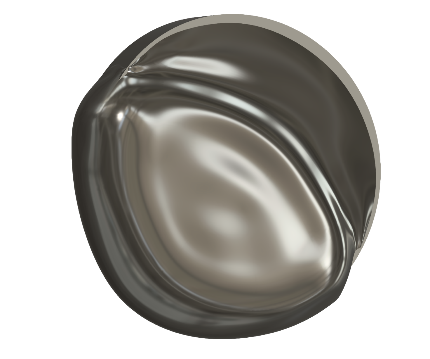

Step 10: Geometry Using Surface Grid Component
After doing some googling, I was interested in trying out the Surface Grid component, which creates a surface out of curves. After playing around with the U Factor parameter slider, I found an interesting shape that I was thinking could be healed in MeshLab and then printed successfully.
Step 11: Healing in Meshlab
I tried a lot of filtering to heal the mesh, including the Close Holes filter (after fixing manifold vertices by removing faces), Laplacian smoothing, merging close vertices, surface reconstruction VCG (which was the only surface reconstruction operation that didn't crash meshlab), and snap mismatched borders. However, I was unable to properly heal the holes in the mesh. So back to the drawing board.
Step 12: Merge Faces in Rhino, Remove Offset
After more googling, I found out that Rhino has a Merge Faces feature that operates on a poly surface. I therefore used a Mesh Smoothing component and then a Mesh to Poly Surface component in Grasshopper, baked the result, and used the Merge Faces operation in Rhino. However, while I thought this might do the trick, the operation crashed Rhino.
My next thought was that the Offset component was causing my issues (see Step 10, differences between the photo with the form in green and the form in red, which was after the offset). When I removed the Offset component and baked the mesh geometry, the surface of the shape was intact but there were lots of holes, which would obviously not be viable for a print.
