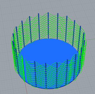

After Step 3, the base and pillars matched each other perfectly, but there were a lot of issues with the fibers (shown in green in the first screenshot above). Since they were still using the parameters from the starter code, they weren't weaving between the pillars properly anymore. This was because the HairPoints cluster- responsible for generating the fibers- took in a fixed number of pillars to weave around (6, in this case). I needed to replace those parameters so they'd be based on the same circle I'd used for the base and pillars.
I passed the base curve (the same circle used in the other parts) as a new input to the HairPoints cluster as well. Instead of using the NumPillars input parameter, which was no longer be used in assigning the placement of the pillars, I divided the length of the curve by the PillarInterval parameter to get the actual number of pillars generated. This was then used to map the path of the fibers around the pillars.
My first few attempts yielded some fairly misshapen fiber meshes, so I messed around with the PillarInterval input value and scaled up the circle a little bit until I got a structure that looked pretty good. There are still some inconsistencies in the weave (you can see some "waves" are wider than others), but for the most part it looked like it would hold up. The second and third screenshots show the final structure from the top and perspective views. It's not a perfectly closed cylinder, but it's pretty close and it should definitely have the fabric texture I'm trying to achieve.
