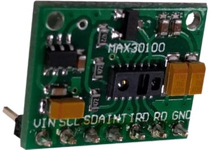

Before going directly into the project let’s introduce the major component, the MAX30100 sensor, which is a simple module that communicates with the I2C bus line with the microcontroller and provides the SpO2 and Pulse information to the host microcontroller unit. In simple terms, this sensor can identify the oxygen saturation Thus, this module has two integrated functions, Pulse rate monitoring and provides oxygen saturation level of the blood in a non-invasive form.
It uses photodetectors and optical elements where red or green IR LED modulates the LED pulses. The LED current is configurable from 0 to 50mA. The image given above shows the MAX30100 sensor.
The above sensor module works with the 1.8V to the 5.5V range. The pull-up resistors for the I2C pins are included in

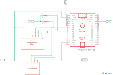

This is a very simple schematic. The pin A5 and A4 of the Arduino Nano are connected with pulse oximeter sensor 30100 and OLED Display with the SDA and SCL pins. Both pins are using a pull-up resistor of 4.7k value.

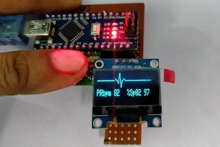

The circuit is made in a small compact Vero board. The data is perfectly displayed on the display. Without any data, the screen looks like this.
As we can see in the below image, the SPO2 level is showing 97% and the heartbeat is showing 82 bits per minute when measured and the animation is also changed.
