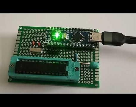

Using Dupont wires is fine for development and debugging, but I wanted something more permanent, that's how I came to make my Attiny programmer suitable for the ones I use: 13, 25/45/85, 24/44/84.
And to keep it compact, I decided to dedicate one Arduino nano to this device.

Step 2: Connect the Components
I used ZIF support to make this device as practical as possible.
Attiny 13 / 25 / 45 / 85 have a compatible pinout for programming, and Attiny 24/44/84 have another, so I used 2 ZIF support.
Here are the connections to be made :
Arduino====>Attiny====>Attiny84====>Attiny85
D10=======>RESET=====>PIN4======>PIN1
D11=======>MOSI======>PIN7======>PIN5
D12=======>MISO======>PIN8======>PIN6
D13=======>SCK=======>PIN9======>PIN7
5V========>VCC=======>PIN1======>PIN8
GND======>GND=======>PIN14=====>PIN4

Don't forget to add the 10uF capacitor between the Arduino's RST and GND. It may work without it, but it will work with it.

Step 5: Test Your Device
Now you have to put an attiny in the appropriate ZIF,
In the Arduino IDE, in Tools/Programmer, choose "Arduino as ISP" ( NOT ArduinoISP ).
In "Tools", the "Burn Bootloader" option does NOT burn any bootloader in the Attiny, but it sets the option (mainly the clock speed ) you've chosen
Step 6: (optional) Coat
I wanted a permanent and robust device, so I put some epoxy resin on the connections and the wires to fix everything.
You can also use hot glue.
And that's it, anytime you'll have an attiny to program, this device will be ready to use!
