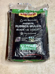

Needed are a sturdy plastic Milk Crate, 1 bag of Rubber Mulch, and a contractors trash bag. Other supplies to be revealed as we go along. There are various ways to go but the emphasis is on using what you may already have lying around.
Rubber Mulch comes in a .8 cu. ft. bag. Putting .8 cu. ft. into the 1 cu. ft. space of the crate = 9.5" depth. This seemed like a good depth and doable with one bag of the Rubber and this project only allowed for one bag!

I put the trash bag into Crate, filled it with the whole Bag of Rubber compacting as I went, Hmmm. Looks like 8" to me. I still need the 9 1/2" depth. I also need something to attach targets to.
