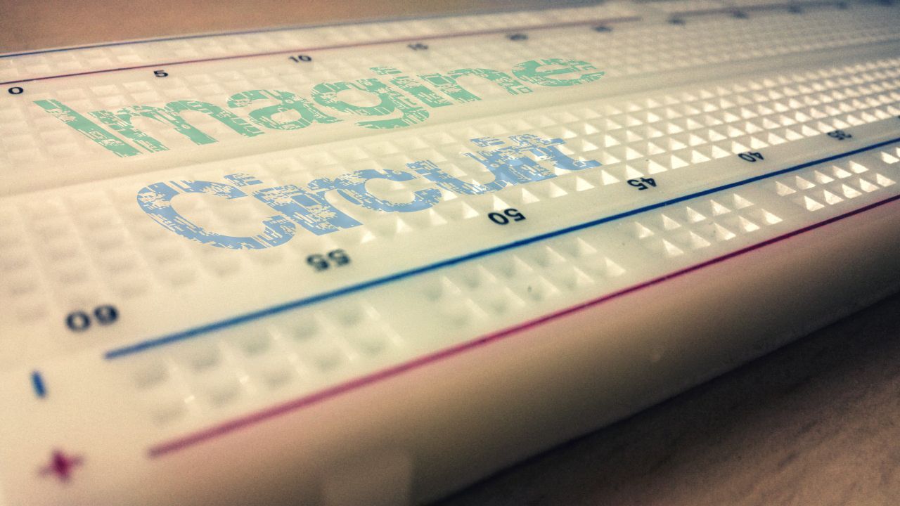

Here are some Pics i took from my cheap lumia 520 phone ,i'm not a photographer but not bad eh ! After editing this might really look very professional.
