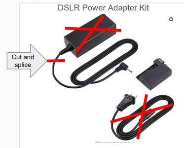

Since there is limited space available inside the box and I did not want a bunch of cords and power bricks hanging out the back with a rats nest of AC power cords plugged into a power strip, I got rid of the Power Bricks.

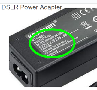

  1. First step was to figure out the Voltage and Current each item requires. This can be done by looking for the "Output" rating on the power bricks.
  2. The example in the picture, the DSLR Power Adapter is rated at 7.4V 2A
  3. PC Power adapter Rated at 12V 3A
  4. Speedlight = 6V 3A : The speedlight takes four of AA batteries. An AA battery is about 1.2 to 1.5V each, multiplied by 4, so about 4.8V to 6V range total. For the current, not exactly sure, but we'll call it 3 amps (An AA battery can surge to over 2 amps for short periods)

  6. Voltage: Find the highest voltage needed, so 12V (for the PC).
  7. Current: Add everything up: 2A + 3A + 3A = 8Amps.
  8. ---I need at least a 12Volt / 8Amp Power Supply---

I did some light soldering and shrink tubing to connect as follows:
  1. Power Brick connects to the barrel plug input, then to:
  2. Mini PC (Because the Supply is 12V and the Mini PC requires 12V input)
  3. Two Buck Converters, which are then connected to:
  4. Camera (set to 7.4V)
  5. Speedlight (now the external flash) (Set to 5.8V)
