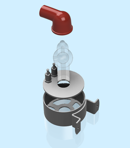

print with TRANSPARENT PLA\PETG tubo vuoto3x and cristallo 3x
print RED cappuccio 3x or paint it
print BLACK pannello 1x and 1x myseal or paint them
print golden or copper tappo3x and cilindrofull3x or paint it
print 4x screw cap if you want and paint in the same color of box
TIPS: for a scenographic switch protector you can print this flip switch cover by by @GiovaGio
https://www.thingiverse.com/thing:3139903

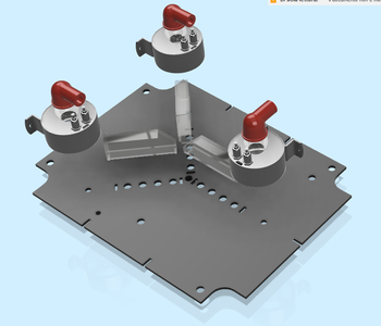

A picture is worth a thousand words! then watch the foto attached to undestand hou to assemble the relays and main panel. Cut 3 pieces of 50mm of transparent tube end inset in the hole of relay transparent section. Cut a copper wire 60mm end put it in the tube. Uou can twist a couple of wires on the 2 terminals of the relay to make it more realistic.
use a driller and a file to give open the windows on the cover of box, you can usa catout.stl to make the hole or MYseal.stl as reference.
Do the same with transparent acrilic foil, try to make the shape of internal cover. Glue the acrilic foil and the "sealing gasket" on the cover, if you use hot glue pure it into a hidden strategic point.
put a black tape on the sides of each crystals, alternatively you can paint it black.
