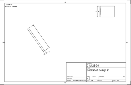

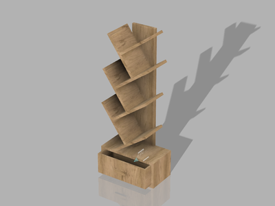

Step 1: Fusion 360
Design and plan out the bookshelf using the Autodesk's Fusion 360.

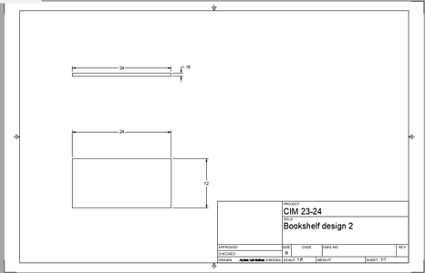

Step 2: Titleblock
Make a titleblock to find measurements of every component you will need to cut out.

Following the design blueprint from Fusion 360, assemble the pieces together.
