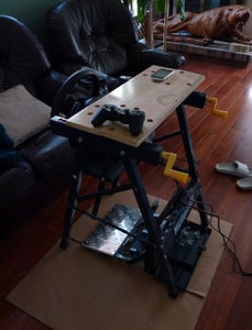

Step 1: Out With the Old
Do you see the problem?
It was an eyesore and ergonomic nightmare.
This was version 1.0:  the workbench racer.

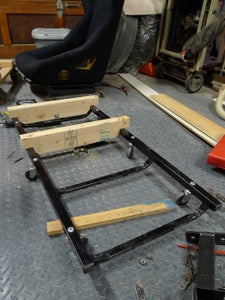

Step 2: Sourcing an Appropriate Chassis
Look around the house for some found objects.
In my case, it was a garage creeper I hardly used.
(You can easily create a mobile platform/chasis by slapping some casters and 2x4's up.)
Head to your local junkyard for a cheap ol bucket seat.
Here, I'm laying out the parts needed.
There are 2 screws on the bottom of the creeper to remove the cushioned surface.
Step 3: Building Seat Mounts
Since the dimension of components will be different for every build. (ie: Seat, creeper, game system, monitor, wheel/pedal setup)
Use this write up as a general building guide, then measure out required mounting points for your components.
Create seat mounts by fixing scrap 2x4's onto the creeper's chassis.

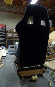

Step 4: Mounting the Seat
Here's the seat mounted using wood screws.
Upon leaning back into the seat, there was a potential of flipping over backwards,
so I installed a small wheelie bar using some spare skateboard wheels.

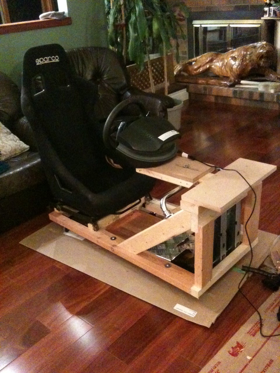

Step 7: Test Fit
Quick test fit, always be testing to see whether it fits you.
In most cases your bucket seat will have adjustments in all directions.
The chrome tube supporting the steering column is an old hand rail.
The steering wheel is mounted to a platform that telescopes back and forth on a 2x4 via a set screw and wing nut.

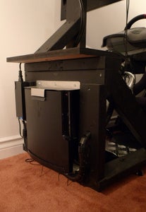

Step 10: Detail: Console Mounting & Wire Management
Tin snips and scrap aluminum flashing bent to form console & power bar mounts.
Zip ties to organize wires.

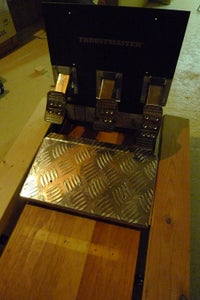

Step 11: Detail: Pedal View
The handrail provide plenty of support to the steering column and enough room for your legs.

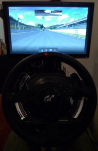

Step 12: Detail: Drivers View
Happy motoring!
