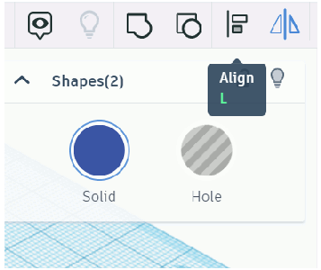

  1. Hotkeys are super helpful:
  2. "Ctrl-G" will Group objects
  3. "Ctrl-Shift-G" will ungroup objects
  4. "L" will show some Lines to aLign (get it?) objects which came in very handy for me
  5. Hacks:
  6. Holes. Making an object or shape a "hole" won't actually look like a hole at all until you group it with a solid object.
  7. Grouping, Aligning, and then Ungrouping objects is a serious time-saving hack
  8. In designing the string winder, I had to make sure some of the interior shapes were aligned with the exterior shapes, with a mixture of holes and solids. To do this, I aligned and grouped some of the parts, then aligned them with others, then ungrouped, and turned a few back into holes. This won't make a lot of sense until you start designing things, but as you do, just keep the idea in the back of your mind how switching up grouping/aligning/ungrouping can help achieve the shapes you need.

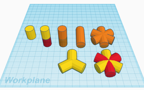

  14. Making & Deleting Parts is useful!
  15. When making the drill, I was stumped on how to create a series of three evenly spaced holes (both for the cylinders and the nuts) in the drill. It's easy to spin a cylinder around it's midpoint - but I needed to spin the cylinder around a central point.
  16. My "hack" was to make two cylinders, stack them on top of one another, then group them. When I rotated these, they were both rotated around the midpoint (which just so happened to be the seam between the two cylinders!). Once the doubled-cylinders were rotated exactly 120 degrees, I deleted the extra and, voila! I had perfectly positioned voids for the screws! (By grouping the boxes for the nuts with the cylinders, I was able to keep these positioned perfectly too).
  17. I've created a screenshot so you can see how this works and a TinkerCAD model so you can try for yourself. You'll note I used yellow/red/orange colors to show the original shapes, when they were grouped/mixed, and when then the temporary shapes were deleted.
