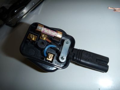

Step 1: Disassemble Plug & Prepare Wire
Have a look at the pics below in order to see what you need to do for the first step
Step 2: Final Step
Put the plug in the plug!
Wire up the wires in this formation, if there is a collar on the wall plug, remove it.
You will need to secure part of the C7 plug under the white plastic fastener for a secure fit.
Tighten all the screws and you're done!
