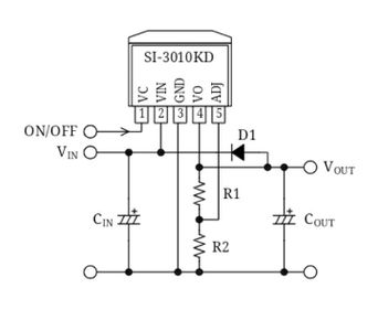

Step 3: BUILD THE CIRCUIT
This is the schematic of our build
Step 4: SOLDERING THE IC
solder the IC 3010KD to perfboard as shown in the above picture
Step 5: Adding On/off Switch(OPTIONAL)
See the first pin of the ic is the on/off switch. If you connect that pin to supply voltage, it will turn on. If you connect that pin to ground, it will turn off. But I just connected it to the 2nd pin(supply voltage). Because I will control it with ac switch on the switch board. If you want an on/off switch, you can add it to the system. It's your wish.
Step 6: Connecting the Voltage Feed Back System
According to the schematic R1 should be our 1k resistor. After that connect your potentiometer to the R2 position of the schematic and solder it to your perf board.
IMPORTANT :
When connecting the potentiometer connect the other end of 1k resistor to the middle pin of potentiometer.
There are another two pins left on the potentiometer.
If you connect ground to the first pin, you will get the voltage increased when you turn your potentiometer counter-clock wise.
If you connect ground to the third pin, you will get the voltage increased when you turn your potentiometer clock wise.
Step 7: Connect the Diode
Connect the IN4007 diode to your circuit as it shown in the schematic.
Step 8: Connect the Capacitor
When connecting the capacitor consider this:
If you are using a S.M.P.S power supply for input, you don't need to connect the Cin capacitor
If you are using a battery for input, you must connect the Cin capacitor.
But in both cases you must connect 47uF Cout capacitor.
Here I am using an S.M.P.S power supply so I connected only the Cout capacitor
Step 9: Connect the Input and Output Wires
Connect the dc jack gnd and one output wire(crocodile clipped wire) to gnd(pin 3) of the ic. Connect the dc jack plus wire to VIN(pin 2) of the ic. Connect the other output wire(crocodile clipped wire) to VO(pin 4) of the ic.
THERE YOU GO! YOU GOT YOURSELF THE COMPLETED CIRCUIT BOARD. GO AND DO SOME TEST RUNS.

HOW IT WORKS
The 3010-KD is an adjustable voltage regulator. We've normally seen the fixed voltage regulator for 12v and 5v. But this is an adjustable version. Here, the pin 5 always wants to maintain a 1v voltage difference between pin 5 to gnd. Here, our 1k resistor and 10k potentiometer is acting like a voltage divider. So it's feeding the output voltage back to the IC. But the voltage can be higher or lower than 1v. So the IC will change the output voltage in order to maintain the 1v on the adjust pin. That's how the output voltage change. Here I used a 1k resistor and 10k potentiometer as the voltage divider so according to the voltage divider formula when we apply 12v the output would be 1 and this is the maximum value our IC can output.
