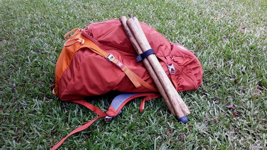

I made this project with the thought of travel in mind. I like to hike and I travel a lot with my work, so I needed an easy way to carry a walking stick without it taking up much space in the car. Plus I like the looks of a wooden stick better than the metal ones.

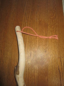

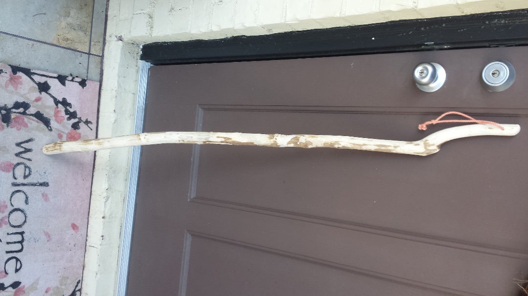

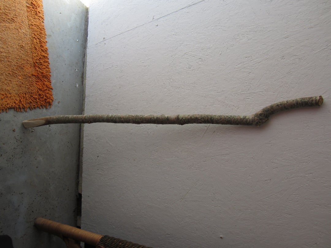

Step 1: First Find a Straight Stick
After you have acquired a straight stick, I found this harder than I thought! So just try and find one as straight as you can.

I found that it is better to cut your stick and then debark and sand, as it helps if you don't get the pieces perfectly lined up. I had already taken most of the outer bark off in these pictures. (learn as you go)

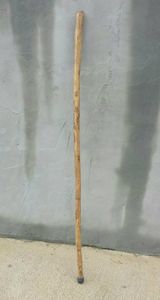

Step 4: Sanding and Finishing
I have now made three walking sticks two I left natural and one I added stain to. But before we get to all of that, there is a lot of sanding to do. Put your stick together before continuing to the next step of sanding.
Like I mentioned before the stick needs to be debarked, then sanded using different grit of sand paper. I used a knife to take off most of the bark. Then used a ruff 40-60 grit sand paper working my way down to 150 fine grit. It just depends on how smooth you want your stick, how fine of grit you go.

You can add a rubber chair end cap to the bottom of the stick so it gets a better grip on smoother surfaces. You can also use a Velcro strap to hold the three pieces together.
Some may wonder about the stability of the stick, because of the cuts. I find that it holds up quite well. I have put all of my weight on it to cross (pole vault style) a ditch. The main thing is to have a stick that is as straight as possible, putting less stress on the joins. Either way it is best to test this out BEFORE going out on the trail where your safety may be at risk!
