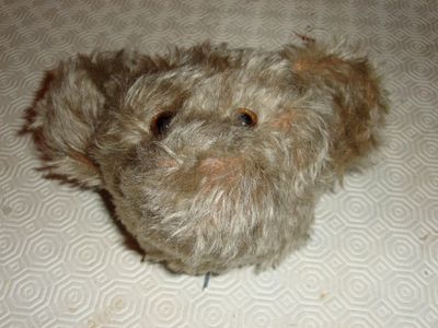

Step 11: How to Get AHead in Toymaking...
Putting the head together is the "Make or Break" step, as almost all of your new companions' personality will be found here.
Stuffing. Lots and lots of stuffing.
For the best results, the head needs to be pretty solidly stuffed..
As before, work the stuffing in steadily. Make sure you get all the corners in the nose/muzzle.
The head should not really have any "give" in it. This is why we are using extra-strong thread, as we don't want exploding seams at this stage.
To close the head up, pull a length of thread approximately long enough to go three times around the neck hole.
Now double it.
Double it again.
Add a little more for luck and then cut it off the reel as one length.
Fold the thread in half, then fold the doubled thread in half again. You will have a 4-stranded thread a little longer than the bit you originally though you needed.
Starting just off-centre of the midline at the back of the head (A in my naff little drawing), using a curved needle, sew this 4-strand thread around the edge of the neck hole in a running stitch, about a 1/4" away from the edge of the fabric.
When you get back to the back of the head (making sure to emerge on the opposite side of the midline [B in said scrawl]),make sure that there is the same length of thread on both sides.
Assemble a final half-joint (1 board disc, 1 washer and 1 cotter pin) and place this in the neck hole, making sure that the board disc is below the line of threads you've just put in.
Tie the first half of a surgeons knot (over-under, over-under again) and pull the neck hole closed like you would a draw-string bag. Be sure to keep the half-joint "inside" of the closure, so that the fabric closes over it.
PULL IT REALLY TIGHT.
A bit tighter than that (this is why we're using a quadrupled extra-strong thread).
Tie the second half of the knot.
Taking the loose ends in their bundles of four, sew them back around the neck hole in opposite directions.
When you get back to the back of the head, repeat the knot-tighten-knot process.
Lose the ends of the threads inside the head.
Close the open side of the ears using a whip-stitch, making sure you have a good length of thread left over to sew the ears onto the head. Put them to one side.
Work out where you want the eyes. There are many ways to do this; sheer guesswork, large headed pins, some kind of proxy (buttons, felt circles...), "dry-fitting" the eyes by resting them in about the right place...
I have a set of "position eyes" for this stage. These are black glass eyes mounted on large pins, which gives me a great deal of flexibility when sorting the eyes out.
Once you have settled on a spot, use the awl to make a hole at both locations. Assuming that you are using them, awl will also help make a bit of space in the stuffing to accommodate the loops on the back of the eyes.
Pull off a length of thread a little over double the distance from the front of the head to the back.
Double it.
Double it again.
Double it AGAIN.
Now cut it off the reel.
Fold the whole thing in half and cut it at the midpoint.
Taking each thread separately, fold them in half, then in half again.
Take the "2 loops" end and secure this to the metal loop on each eye using a Lark's Head knot.
Now it's time to break out the mattress needle. Thread the first "eye bundle" onto this beast and slide the needle into the head.
The point of the needle needs to emerge just off the centreline of the head at the back, on the same side as the eye, down towards the neck.
Do the same thing with the second eye.
It is now time to secure the eyes.
Tie the first half of a trusty surgeon's knot with the eye threads.
Now comes another fiddly bit...
You need to pull on the ends at the same time as gently pressing on the eyes to shape the head.
This is best done by cradling the head in your hands, using your thumbs on the eyes and pulling on the threads by wrapping them around your forefingers.
Finish the surgeon's knot and lose the ends inside the head.
Your companion has eyes to see by, time for the ears next.
Test-fit the ears to find the right position, then sew them on using the curved needle. A ladder stitch works well here.
